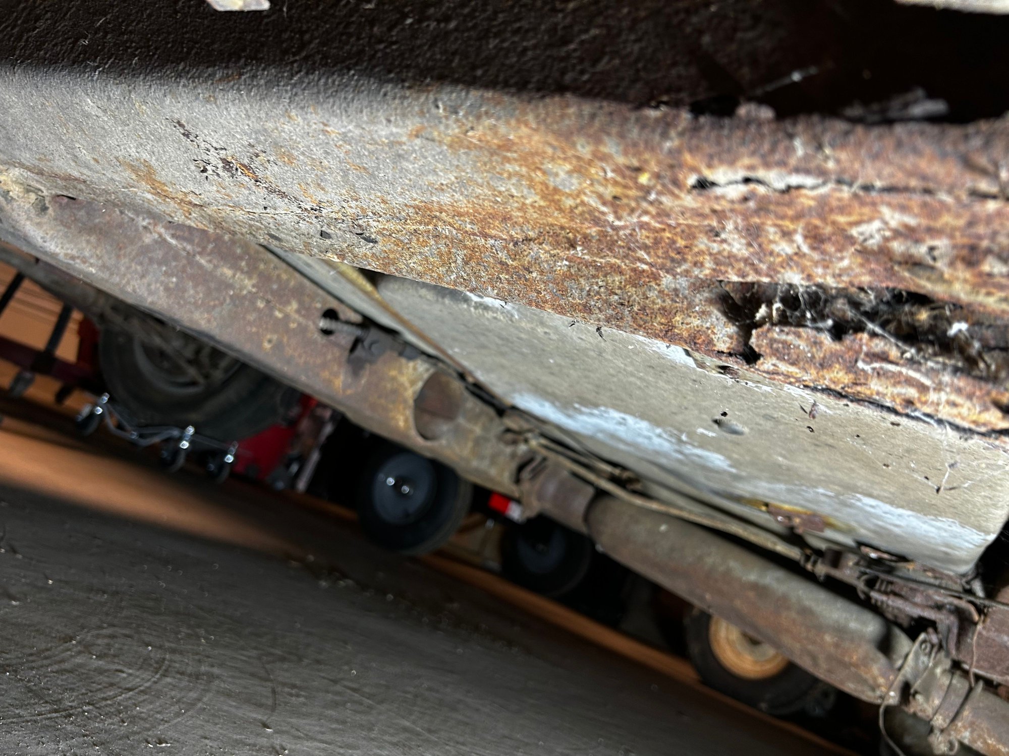

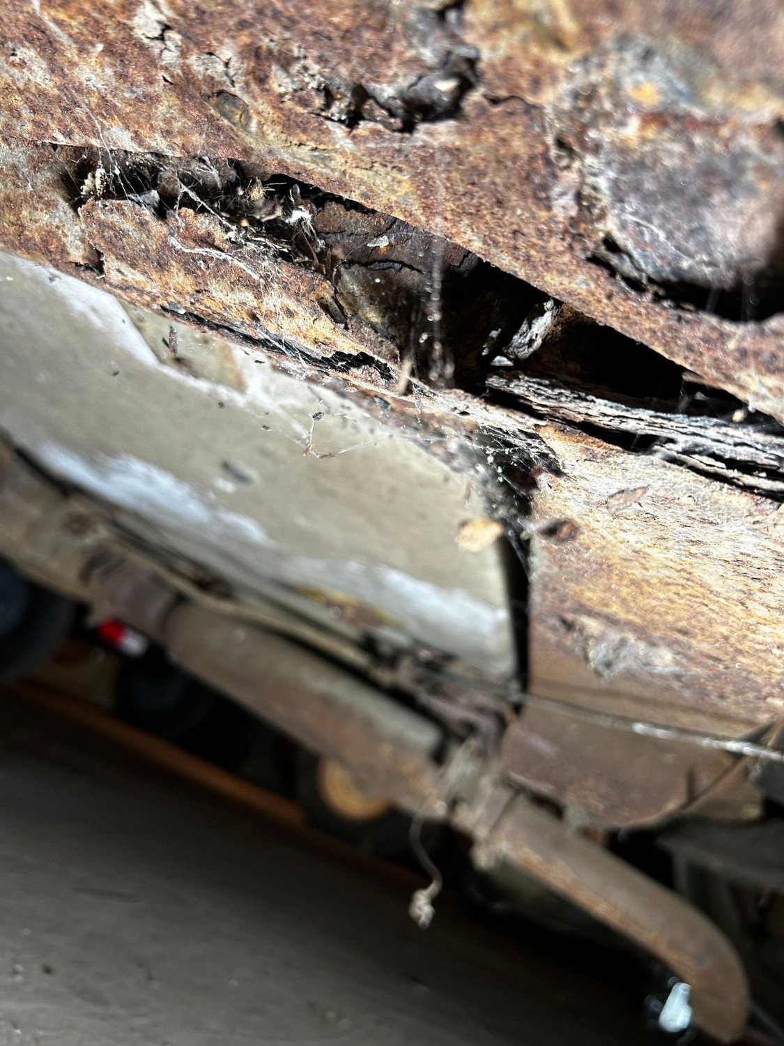

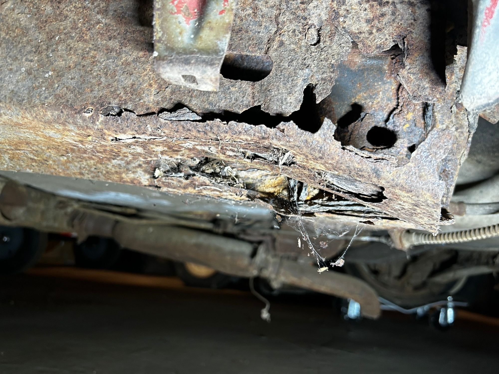

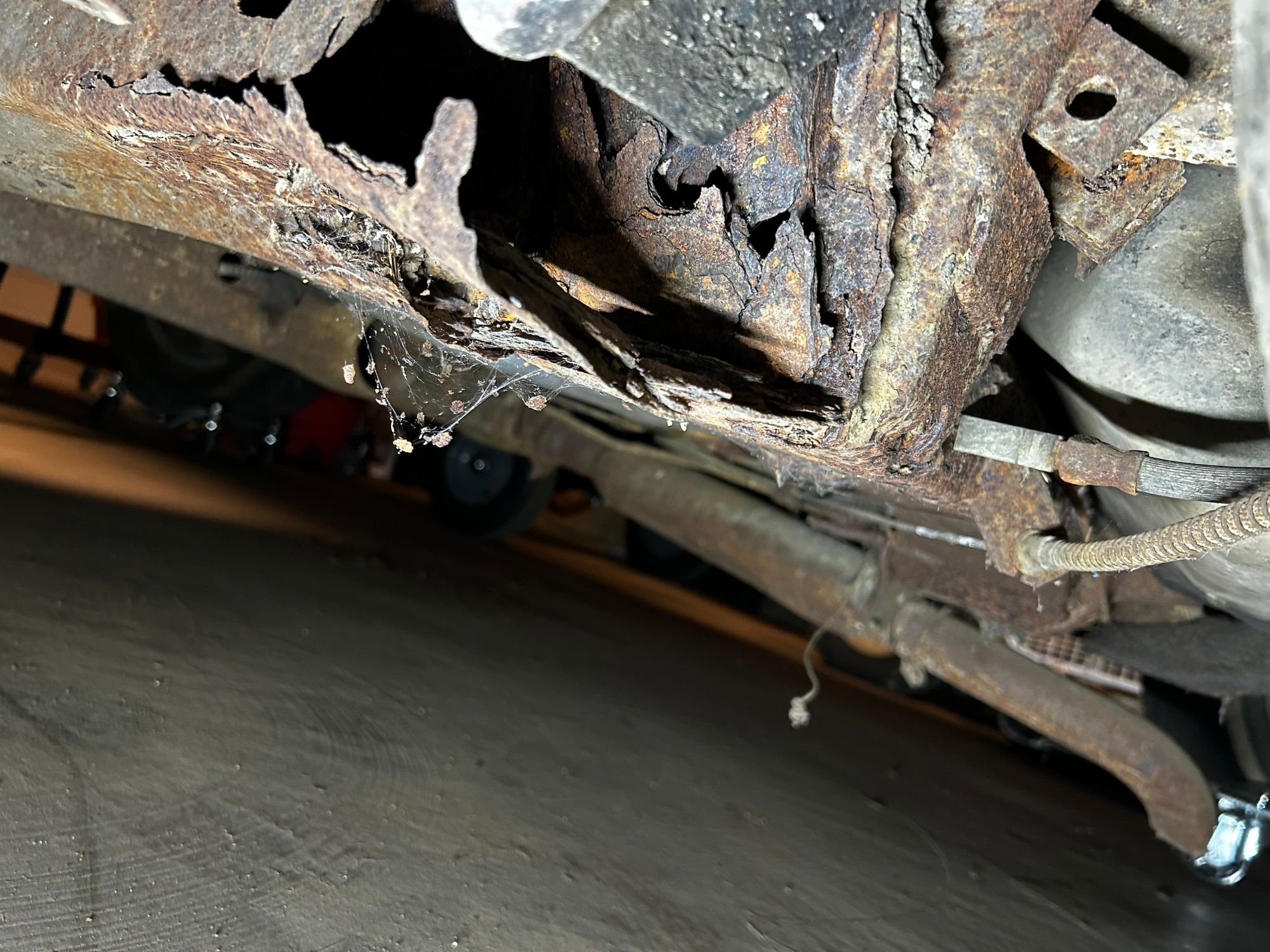

Hello All,
I am looking into what to possibly do with this 1964 Corvette frame. It looks a little punky/rusty in the drivers side right before the kick up over the rear axle along with someone did a number on the motor mount area
. A couple of questions regarding this.
Is this something repariable or is this a oh no and replace the frame? If replacing the frame is the better option where do I get a frame?
I'm attaching the pictures I have but they may not be good enough to get a view of the full damage. If you all want to chime in to let me know what your thoughts are it would be good to start somewhere.
Thanks in advance,
Bill

"A little rusty" ??? Anything can be repaired... but if it's that bad down below.... who knows what else is going on from the frame up.

Three options. Vette products of Mi makes new frames and repair sections. The repair sections you're going to cut and splice and be a good at reading a tape measure. Or you can find a good used 64 frame from resto mod builders.

No doubt you need a new frame and not bunch of repair pieces and hope your birdcage is not equally rusted. Dennis

Mine was bad, I found a good (actually excellent) '66 rolling chassis. disc brakes, new lines, lots more. Saved me a ton of work and hassle. Lots and lots of guys going the restomod route, you should be able to find something better than fixing that up.

Railroadman.... thats exactly what my 64 frame did when I pulled the body. Seller stated that the frame was a little rusty ! I put a 78 frame under it.

Welcome to the 64 club! Frames show up often on the internet, start looking and you find one in no time. I would not not waste any time on a rusty frame with today's frame surplus from restomods.

Unless you have a rare Fuelie, a '64 is perfect for restomod.
I'd seriously think about getting an aftermarket frame. But be prepared to spend $30k for a good one with new suspension on it. C4/C5/C6 suspension.

I ran into a similar problem when I pulled the body on my 64 Roadster. I had the frame dipped by International Paint Stripping to remove all the rust. Removing the rust revealed the true extent of the problem. I took my frame to Vette Products of Michigan in Clarkston, They basically replaced the frame from the transmission crossmember rearward. They have a surface plate/jig that they use to build new/replacement frames. My frame was repaired in that jig. Not only do they supply/build new frames, they have the dies to stamp every frame component. I am very happy with their work. I had Big Bill at QC Powercoating in Shelby Twp. powder-coat my frame after the repairs. The rolling frame turned out show quality.
If I could have found a clean used frame for a reasonable price at the time, I would have gone that route. I would still have the frame dipped and coated.

If you want to keep your frame (it is serialized), there is another guy in Michigan with a C2 jig, Roger's Frame Restorations. With pictures, you can get an estimate for comparison to other options mentioned.
