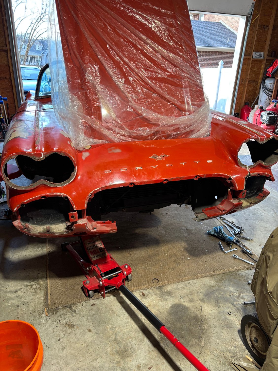

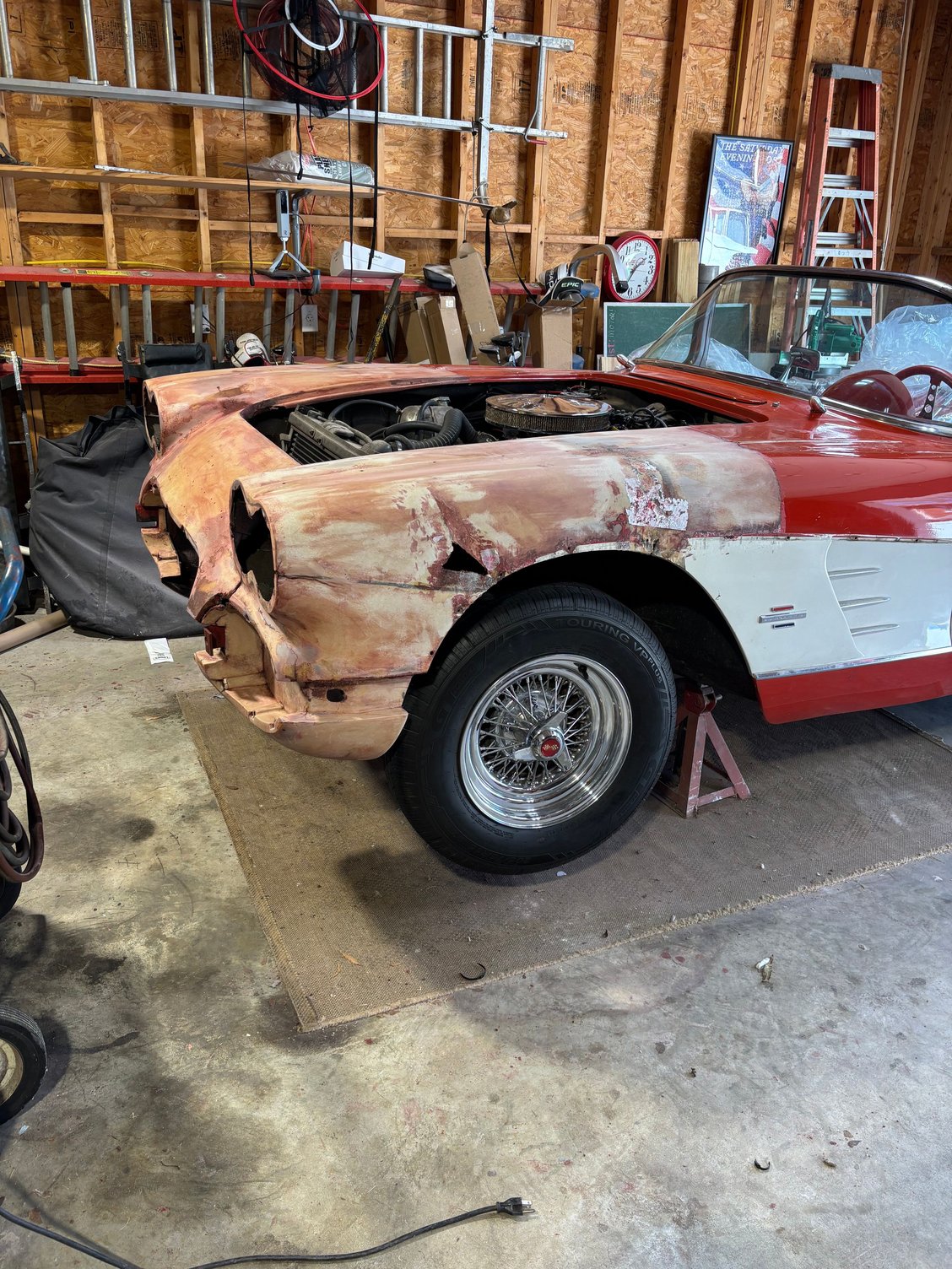

I hate for anyone to see it at the moment. I have the paint stripped off the front ready for my favorite corvette fiberglass guy to repair. I am assuming that the previous owner couldn’t stop quickly enough with the drum brakes.
anyway the car is sitting about 3 inches higher than it should. Take a look at the rear shackles turned upside down. The front end must have taller springs installed. Someone must have been going for the gasser look under previous ownership.
I did patt her on the butt and tell her she was safe now. Bubba can’t hurt her anymore.
