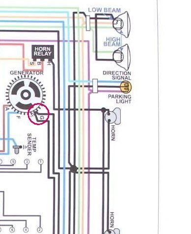

The first thing I would do, is make sure the headlight grounds are connected to a good ground upfront. Add a ground from the bumper to the headlight socket and see if that light brightens up. I suspect you don't have a good ground. It's possible to have low-voltage causing it, but I'm betting on the ground circuit.
The 61 wiring diagram shows all the front lights are grounded at the generator case.

Thank you for the replies. My first inclination is also a bad ground. One question, in looking at the wiring diagram, it looks like the headlight grounds to not tie into the generator, but rather to a junction that ties them all together, along with the horns, and that junction then has a wire that travels inside and connects to a series of grounds that covers the under-dash components. Do these junctions mount to the frame, or if not, does anyone know where they eventually ground to metal ? On the diagram it looks like they all just ground to each other.

They ground to the generator case which is bolted to the motor, which is grounded to the frame by a strap. If you notice the junction does not show a ground. The only ground shown is right beside where the black wire is bolted to the generator case. As I said earlier, you can run a temporary jumper from any known good ground either battery negative or front bumper, etc. to bypass the ground. connect it to the black wire coming off one of the headlight motors or at the black wire where it attaches to the generator. Before you spend any time troubleshooting wiring do that to verify that your ground is what the problem actually is.
all the diagram is showing you at the junction is that all the wires have the same ground.
