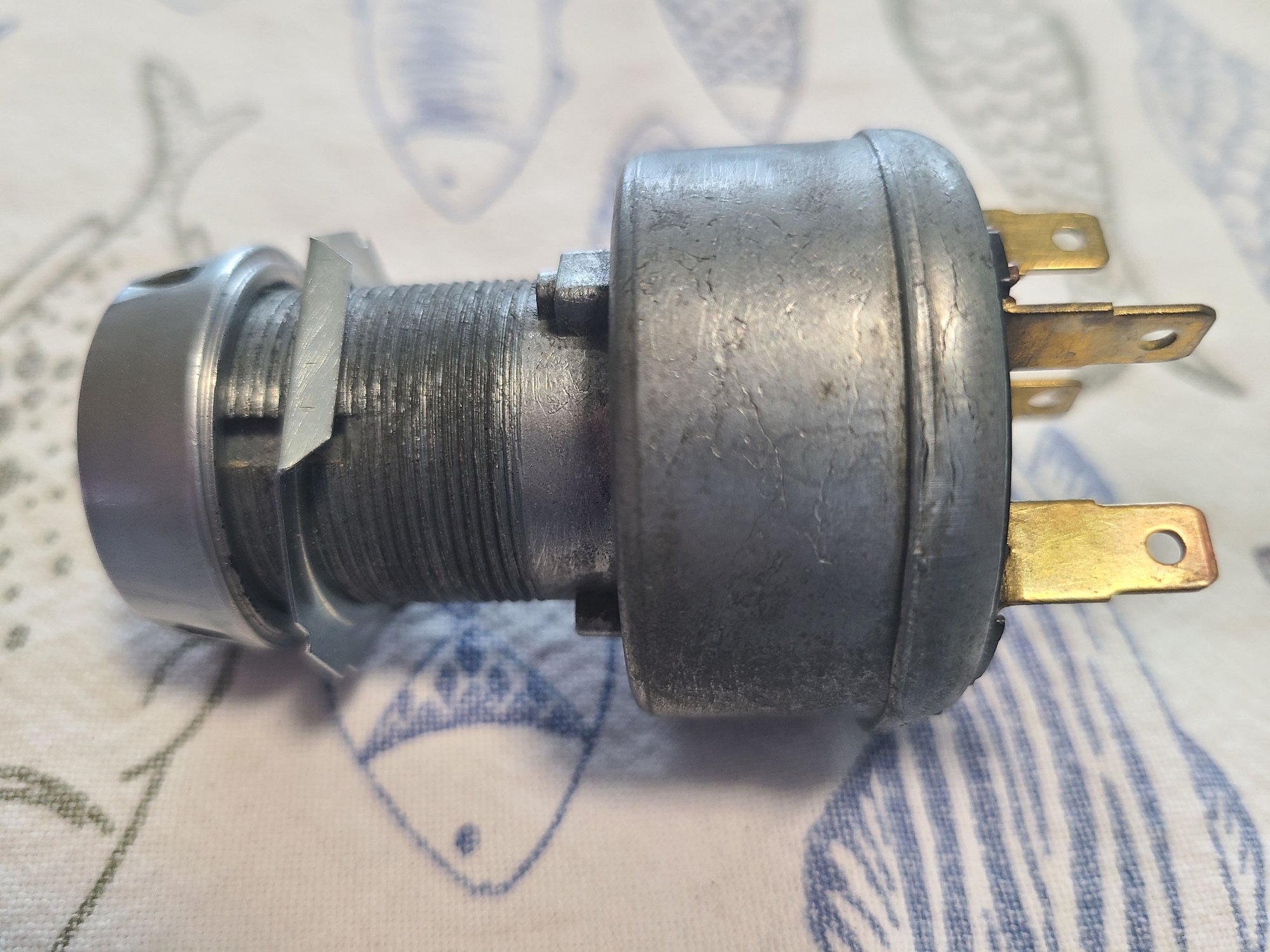

I've got the ignition switch out of the 65 and I'm preparing to install new dash and engine bay wiring harnesses. Before I pulled the switch I was having electrical problems and I'd like to test it. I didn't find any recent posts on testing the switch - so how do I test it?

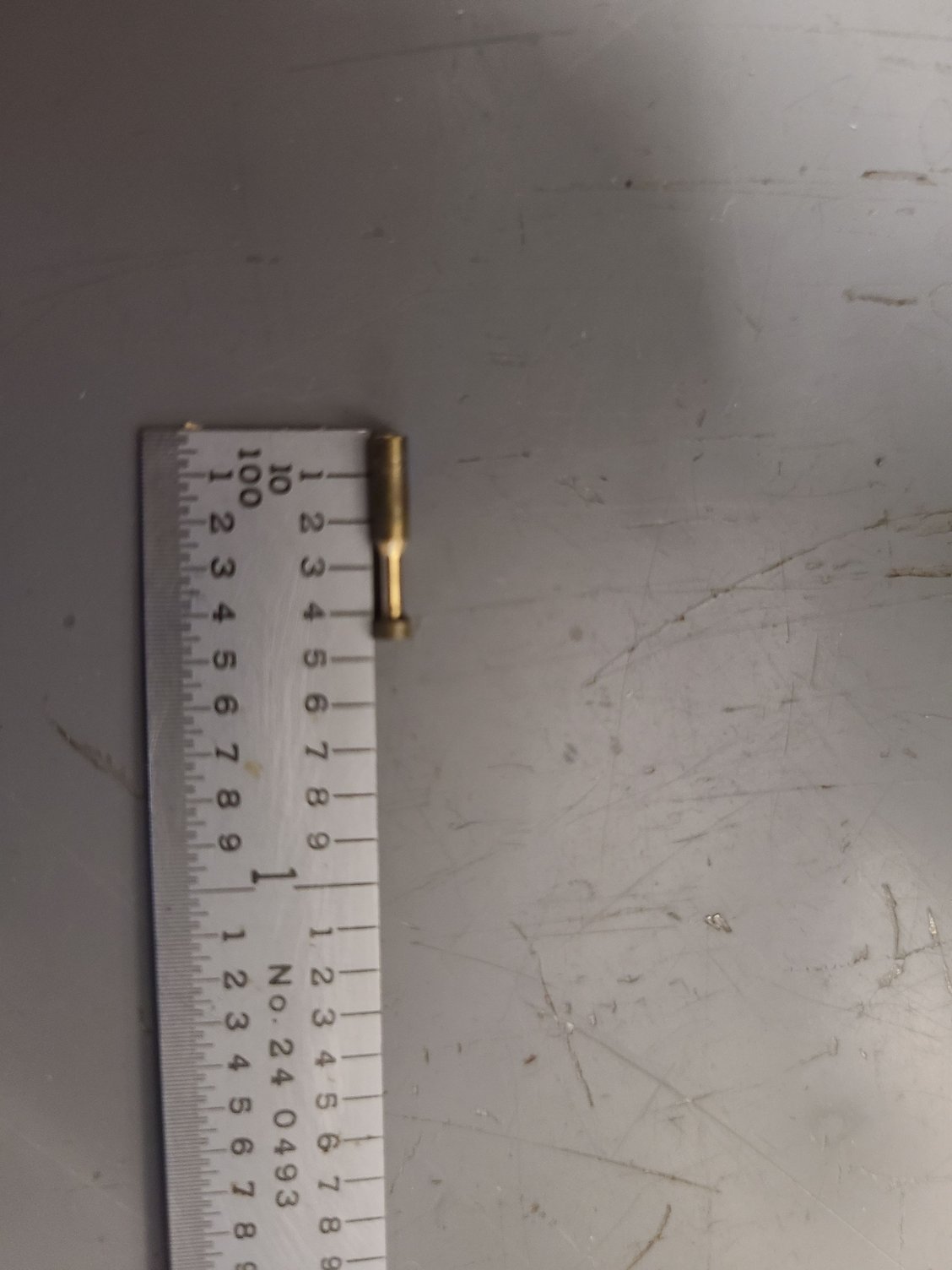

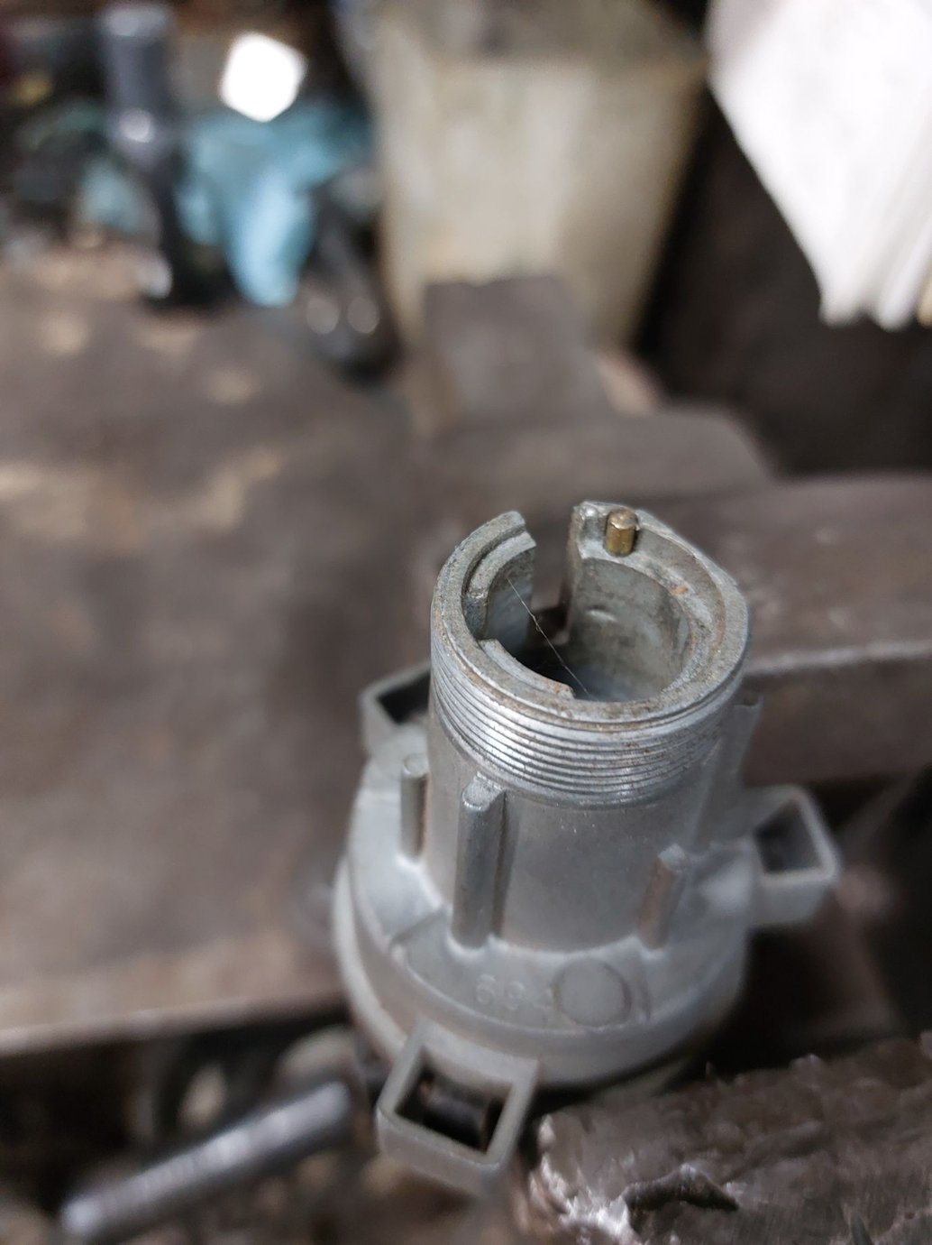

Also - the picture below shows a small brass pin that came out when I took the switch out. Does anyone know what it is?
Thanks - Gary

On the back of the switch it is marked IGN, BATT, SOL, ACC, etc.
You can apply 12vdc to the BATT terminal and then check each position of the switch with a 12vdc test light or
Use a multimeter on the OHMs scale. Attach the red lead to the BATT terminal and measure the resistance on each lug by connecting the black lead to the applicable lug for each position of the switch. Then test all of the lugs when the key is in each position to assure you do not have a short inside the switch.
You have to have the key in the ignition to turn it to each position.
Did the pin come out when you removed the tumbler (key part of the switch)? A ruler and the diameter of the pin may be helpful. It could be part of the tumbler, but it has an unusual shape.

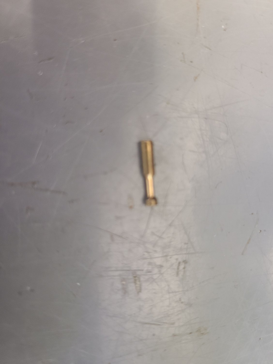

Thanks Ron - yes the brass pin came out after I removed the tumbler and was in the switch after the tumbler came out. It's about .085" OD
Here's a better picture.
Gary

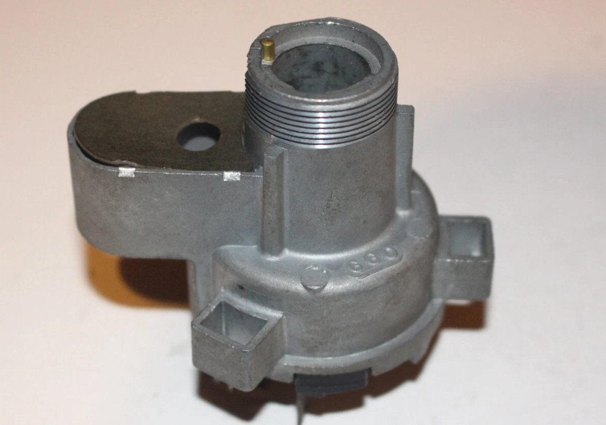

There is a pin in the switch housing which you depress to remove the tumbler. The pin is about 1/16" diameter, but I have never removed one to measure the length.
Is that pin missing in your switch
Brass pin in switch housing.
housing??

Measuring resistance on an ignition switch is only helpful for shorts and opens, but it does not speak to contact performance.......which a voltage drop test is best.

Thanks! That's it, and it fits in the hole nicely. It doesn't want to stay in the hole, so I added a dab of grease and it seems fine.

There should be a spring behind the pin to push it out. There appears to be an indentation in the inside of the switch that held the pin in, but I have never taken one apart.
The photos that I posted are a 660 switch for the 65. As smacota1 stated, check the numbers on your switch. If it was replaced before, the plastic connectors are different as well as the lugs on the switch. There are only 3 numbers on the switch. I have the 660 and 694 and 697 switch on the bench.
You want to make sure which you have and test it. If the switch is shorted internally, you may burn up a new harness if you don't test it first Also, check the wire to the ballast resistor, if it is burned, you may have a short in the ignition system devices, or if you run the chrome cover, it may have cut the wires to the coil or distributor.
As lucky131969 stated, a voltage drop test is best. You hook the known voltage to the BATT terminal and test each terminal for each key position to see if there is a difference in the voltage reading in and out. You have to have a VOM multimeter for that test. If you have a VOM meter, you might want to do an OHMs test first for information as it will show a short or open.
The switches are not hard to disassemble and inspect the contacts, I have done quite a few. I don't think you will find parts to repair it if the contacts are beyond burnishing.

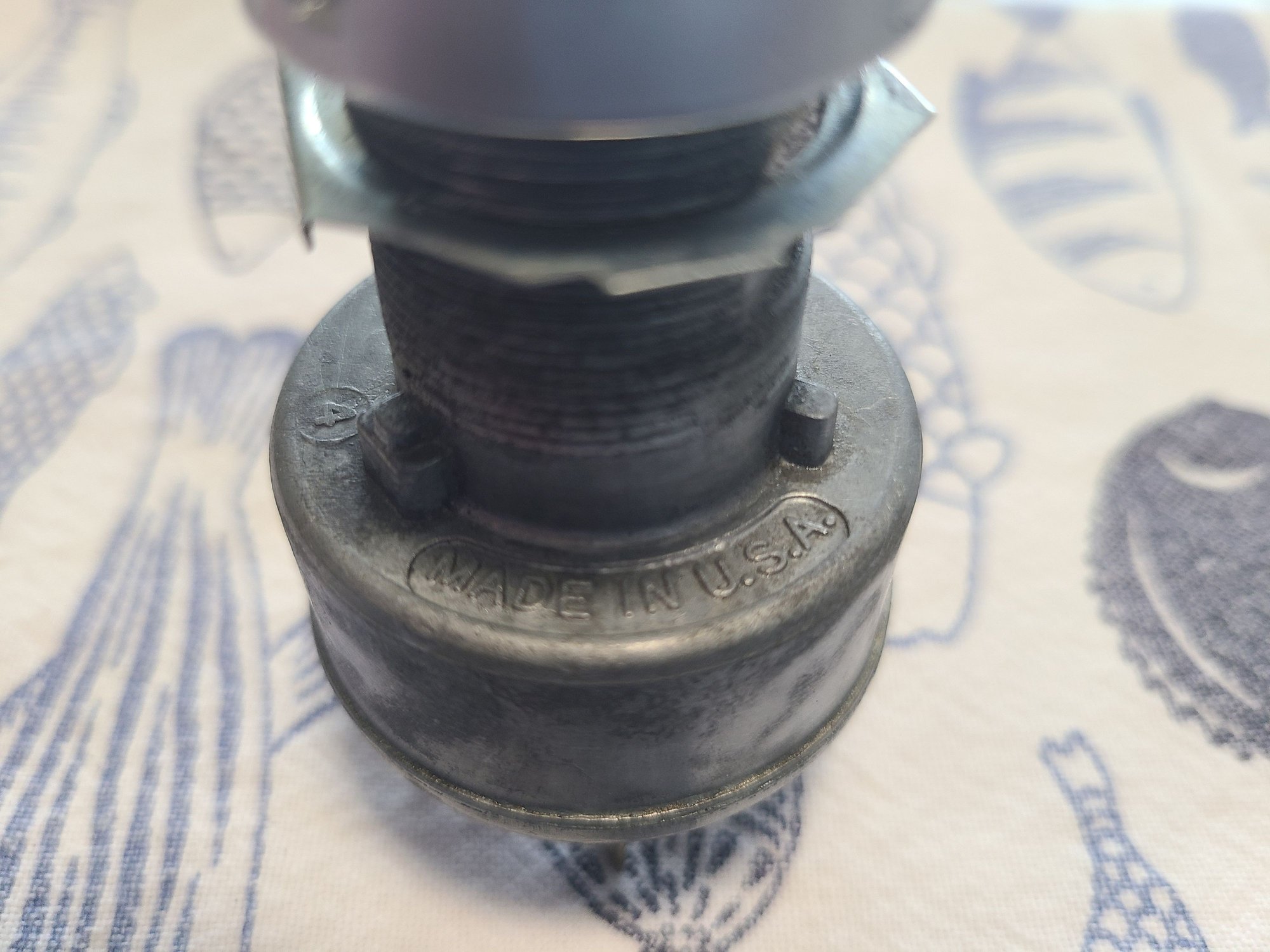

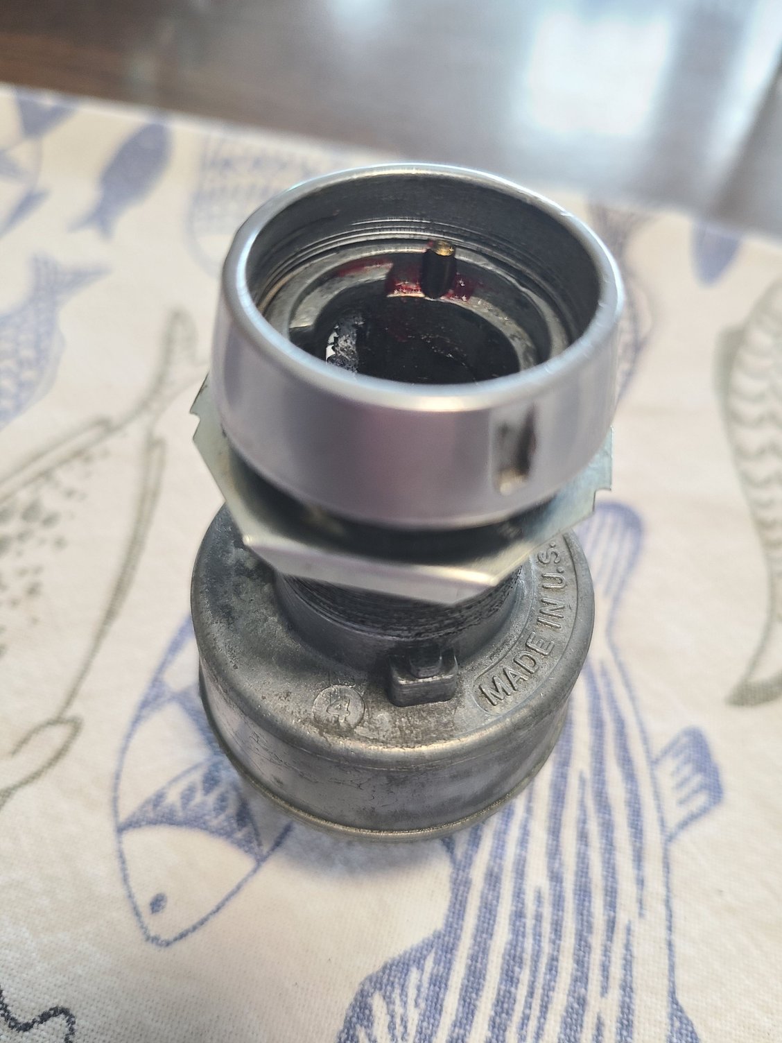

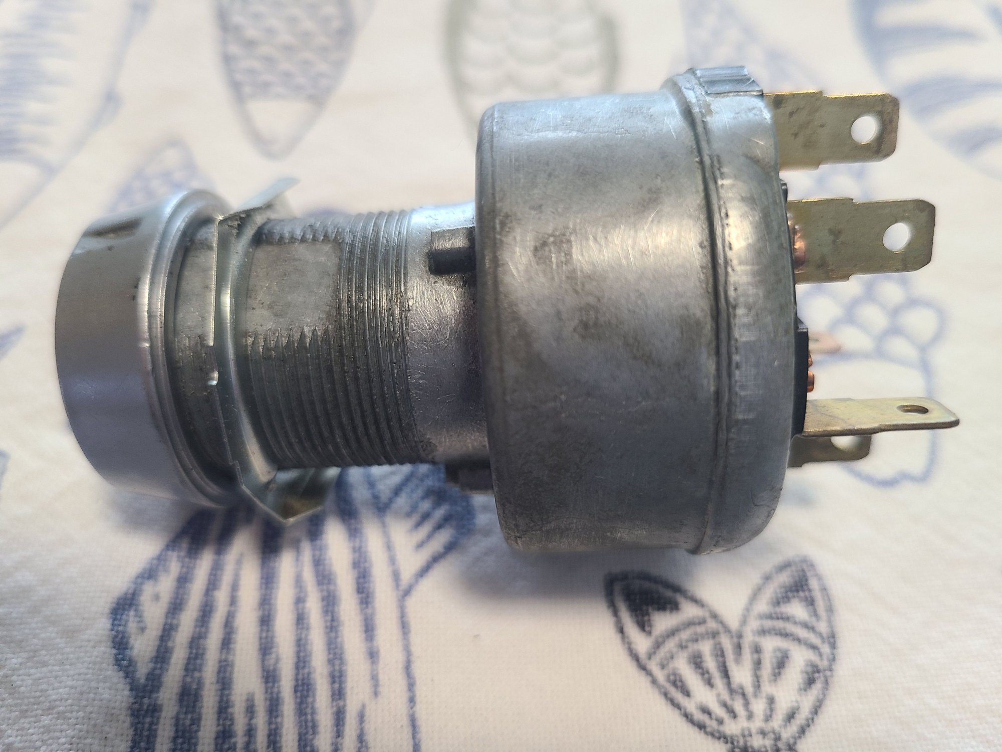

I can't find any numbers on my ignition switch, and it looks different than the pictures Ron posted. I'm wondering if it has been replaced at some point.

It does indeed appear to be an aftermarket replacement for the Original 660 switch as it does not have the loops for securing the connector nor the light holder cast with the switch.
Now the question is whether the connector is original to the 65 as this may be a problem when you get a new harness, if that is your plan.
I am trying to think of a way to accurately compare the terminal / lug placement on the back of your switch to that of the 660 switch I have.
Due to the crimp around the contact board on your switch, it would be very difficult to disassemble and repair. Aftermarket switches are very cheap, but sometimes the tumbler won't work with a new switch as well as the terminals on the board. IF you are ordering a new ignition wiring harness, you may want to order a new switch with tumbler and keys from the harness supplier to fit. You can have the tumbler rekeyed to match the existing key if you chose.

Thanks Ron - I checked Lectric Limited's catalog for my car and I don't see that they offer an ignition switch. Our 65 was built in January of 65. I think I'd like to source a new one. Would that ignition switch full part number be 1116660?
