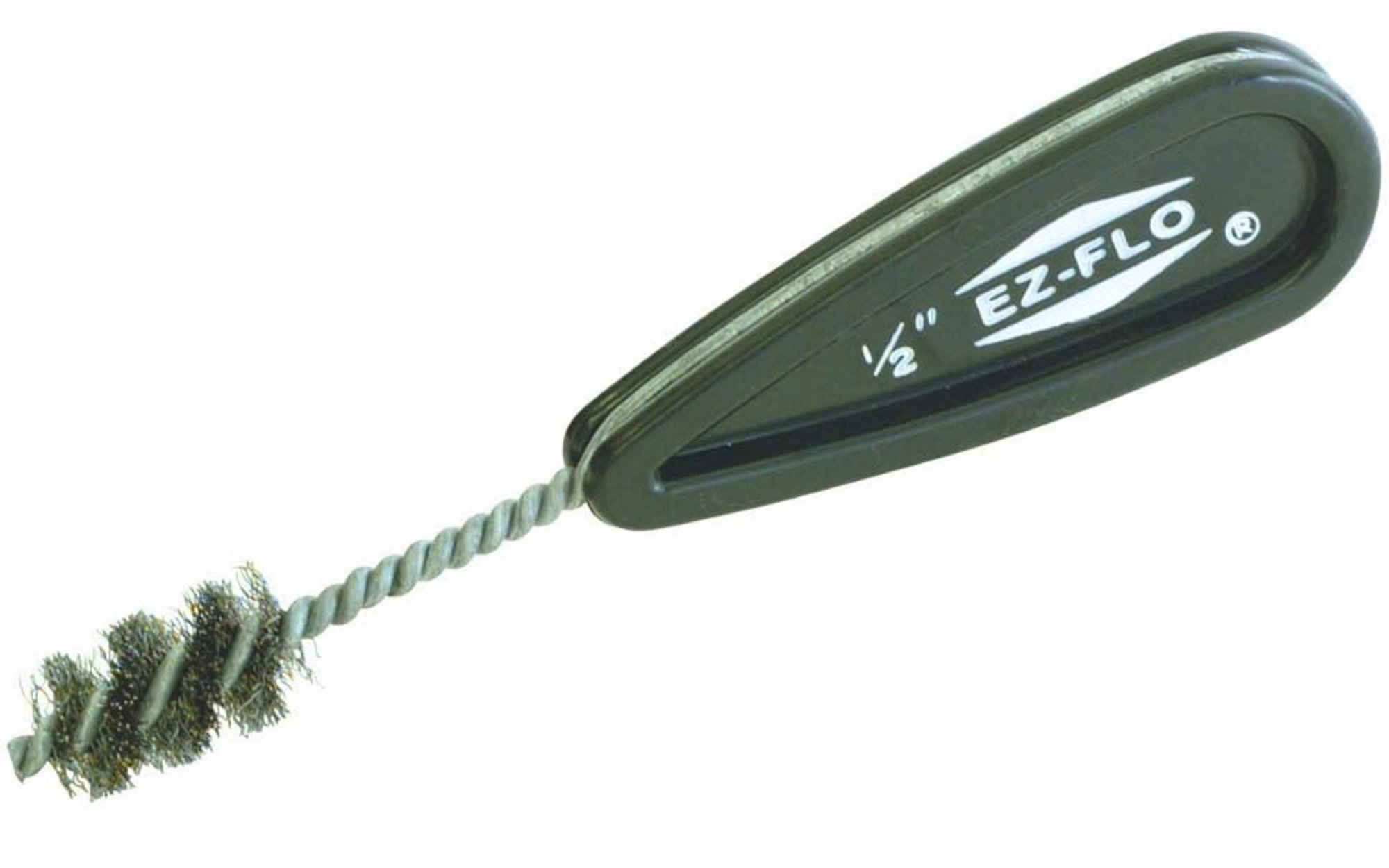

I will add that a brush made for cleaning 1/2” copper pipe is the perfect size for cleaning and removing corrosion and oxidation from these light sockets. That might be part of your issue.
$5.00 on Amazon
$5.00 on Amazon
