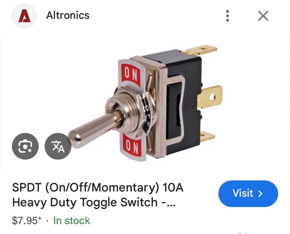

You could just mount one of these under the dash

You are not allowed to use an off the shelf switch. That is Corvette Tax evasion and makes you subject to severe punishment.
