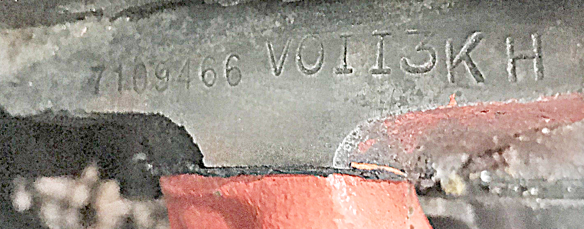

Originally Posted by aquaroscoe
Are all VIN/option codes on the motor stamped in an aligned manner? I have what I believe to be a numbers matching motor, however the numbers do not look like they used a holder (stamped individually) rather than all at once. The engine Serial number option code number is very clean/aligned. The VIN (left side) number seems to have been stamped using individual stamps. Since the car has AC, A.I.R., PS etc. The pad would not have been easy to get to after assy, does this explain why the numbers would have be so erratic? Anyone have pictures of what they should have looked like on a similar optioned car?
1967 coupe, L-79, AC, A.I.R., PS, PB
-Matthew
Cloudysky@sbcglobal.net
is this a correct stamping ?
KH is the suffix for L-79 w/ AC, K19, Manual trans, and Power Steering. Stamp looks good to me. Probably should start a new thread.
