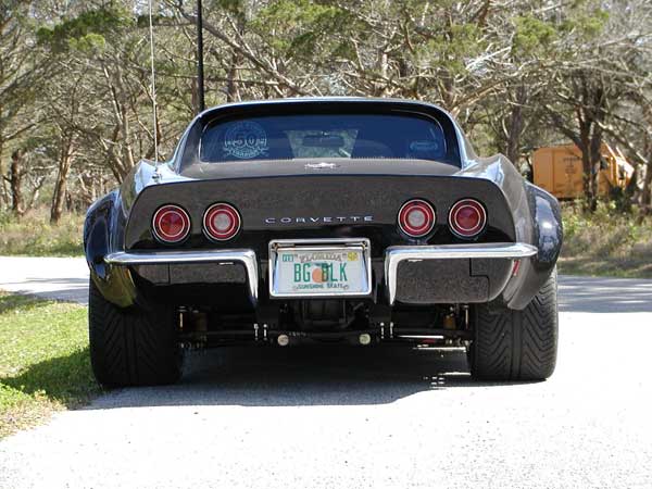

I never thought much about flares, but the flares on these cars are done so well

These are radical customs, but look past that part and you can get an idea how the pulled fenders look. It's really NOT difficult to do if you can do basic glass work. You pull it out in the center, prop it with a block or such, glass back together. Pull the block, build extentions to the inner fender to fill the opening (I use cardboard, glass over it, grind the cardboard off. Can build any shape that way easily). Finish the glass work and paint. It's so subtle that you look but don't really see that it's pulled out that much. Even my radical '66 has the front and rear fenders pulled out...way out 10", and THAT IS NOTICABLE!
This was HIS design, NOT mine!

PAT, I have a couple of questions if you don't mind answering them.
First, how much did you add to your 2 1/2" flares?
Second, What rear wheel (width & BS) and tire size are you running?
I'm hoping to run a 5.5 BS with 5.5 to get 11 inches of wheel under the rear. The two inch additional wheel well should allow another 1.5 of offset.
Front is not that important but interested in seeing what you run there as well.
Looks great! I'm planning on buying the set RedVetRacer has, I think these will do what I am looking for. But I would like to see what you are running anyway. Thanks Jim

prosouth, jim they were 2 to 2 1/2 inch flares that i added approximately 1/2" to 3/4" to them and also dropped them down a bit to tighten up the wheel well spacing.My rims are 17x9.5 with 4 1/8 back space,at the time i didnt want to remove the sway bar but if i did i couldve fit 17x11's no problem.Which i still might do this winter,sell the 2 rears and have 2 -11's made for it and remove the rear bar.Itsd reall yhard to say what i gained now without having the old quarter in front of me now.

Thanks Pat, Looks like someone got in front of me on RedVetRacrs flairs so I may have to find a set from a vendor. Anyone have any idea who makes this size or where to get them?
Thanks JIM
