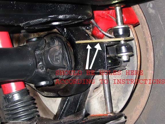

Installing sway bar on 1970 convert. Instruction indicate there should
be two holes where white arrows are pointing in picture below.
I don't have holes. Am I supposed to drill holes in top of trailing arms to mount bracket or did I get wrong sway bar for 70 vert.

Yes on drilling the 5/16" holes. That part of the picture is correct.I don't know where you got the picture but it is wrong. You also need bushing at the sway bar itself. I don't see that in the picture. On my '81 the holes were already on the trailing arm but the ones on the frame were well "hidden". After laying out the holes on the frame I noticed a slight imperfection in the paint. After digging around with a scratch awl I found the first hole. After measuring over 2" I found the 2nd hole. Apparantly they fill these unused holes with some type of putty. After cleaning them out I had to rethread with a tap to clean out the thread holes. I was sure glad that I found the holes as I would have had to drop the mufflers. With the holes it was an easy installation. Good luck. Post a picture when done.

The photo is mine. What do you mean the photo is wrong. I found the holes in the frame where the clamp and bushing go, but the instructions indicate putting the brass looking plate on the top of the trailing arm with two bolts coming in from the top. I have a second smaller plate with threads that slides in the opening in the arm and the two plates are then bolted together. Instructions say holes should be there but they are not. Before I drill the holes would love to know why you say the photo is wrong.

Here is photo of my 69 sway bar mount:
I'd say your instructions are ok...but I'm not familiar with the aftermarket mounts...that could be the confusion in your pic...???

yours is the same as mine. I was just confused since the instructions indicated the holes were already in. I guess I will have to drill my own.

Be sure and re-check for those holes with a punch....both my vettes came with sway bars,and I'm not sure if holes were provided in all vettes or not...
Thanks
There is nothing wrong with the bolts or mounting holes. I am refering to the bushings. You show the 2 at the bottom but I don't see 2 bushings at the sway bar.

Take a closer look at the picture... you cant see the sway bar itself... instead what it looks like is you are seeing the bottom of the cushion under the sway bar... the bar itself is occluded by the frame...
As to the swaybar install itself....I cant say that thin plate instills me with much confidence. A good sized swaybar will bend that plate over time I think...right at the rearmost bolt.
