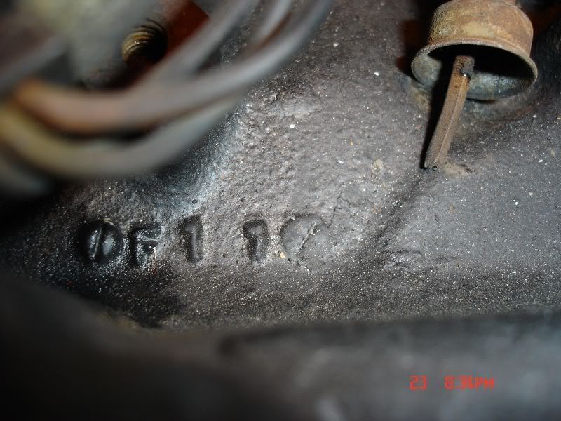

The guy I bought the car from said it's a crate motor. These are the numbers that I can find on my engine. What can you tell me about it? Am I even looking at the right numbers? Thanks.
-Peter
I found the following 2 numbers between the carburetor and distributor.
I found this at the location of the stamped pad.

3973469 350 1971 4-Brl Quadrajet if the number posted was on the intake. I cant read the pad so I cant help you there on the block.
Good luck!

go to the very back (close to fire wall) top left or right side of the block and you should be able to find a couple of numbers there

Casting date for the manifold.
