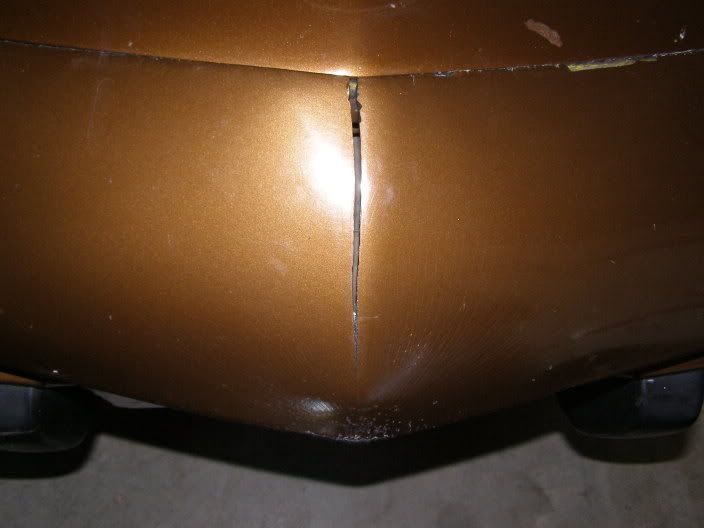

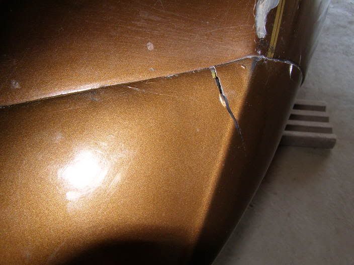

My front bumper is cracked right in the middle so I need to replace it anyway but the other day I noticed that it had cracked on both sides now. The front was cracked when I got the car. But I have had the car for 2 years and now these cracks just showed up.
I did have it jacked up replacing the spare tire carrier. I put jack stands just in front of the rear tires. Do you think my car is flexing too much? Should I be looking for something? My frame seems pretty solid, but this seems wierd. What do you think?

This is very common on these 30 year old bumpers. It is time for new ones.

Welcome to the club! Your rear bumper probably isn't far behind.

When the first crack appeared on mine, I blamed the kids for running into it with their bikes. Then other cracks started appearing and before long the bumper literally started falling off the car. Its time for a new one.

They just get really brittle and fall apart after about 25 years.
The newer flex-glass replacements work well. I look forward
to replacing both ends on my 74. It is a "work in progress"
for this "diamond in the rough".

Originally Posted by 7T4StingRay
You may already know this, but you should always crack the doors, pop the hood, etc whenever jacking the car to allow for flexing.
If your car is damaged from jacking, you need a new frame immediately.
Your front bumper is not likely cracked from jacking ... just it's time to go.
