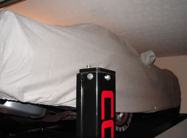

I got one from Greg Smith in Indy as well. I wanted an Eagle simply because they offered a red paint option. But for the price, Greg Smith was a great choice. I don't have it bolted down and don't have any stability problems. It's very solid.
Sweating bullets the first time I tried it. It's a newbie thing. I left my truck parked on it for a couple days before I would let a Vette get close to it. It's also strange the first time you drive under a lifted car. It's all silly now, but takes a while to get used to it and trust it.
Are you considering any options? The best thing I bought was the aluminum ramps. I had the steel ones for a while and hated them.
I would also like the lift cycle to be quicker. I think there might be an option for faster motor. But overall the lift is excellent.
