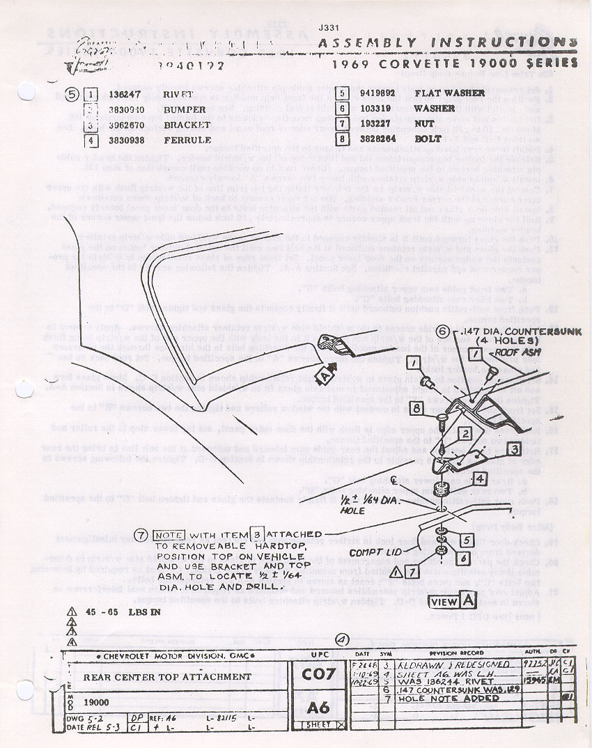

Default AIM Rear Center Top Attachment Page
Sorry for the quality of the image. Niether copy of the AIM that I have is very good.

The Third Edition of the 1968-69 Corvette Technical Information Manual & Judging Guide, Page 32: "...In very late 1969, a third mounting bolt is added. This is located beneath the rear window and extends into the passenger compartment on an L-shaped bracket. The bolt passes through a ferrule in the rear deck lid and is held in place by a nut..."
The 1969 AIM shows the center mount on C07, A6.
