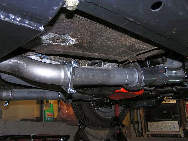

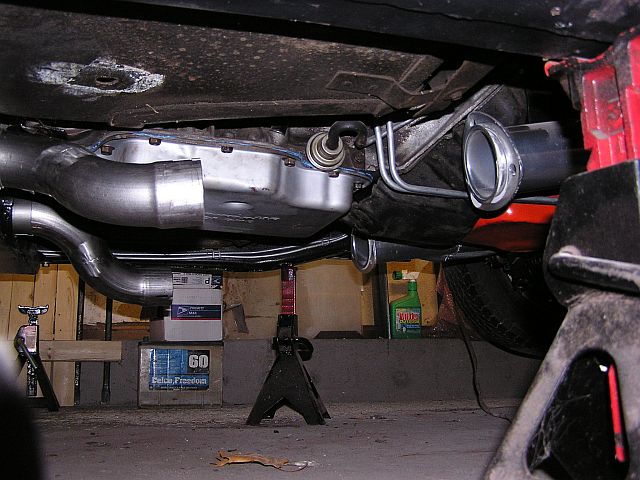

I used the Hedmann extensions from Summit to connect up my headers, I could have given you exact dimensions yesterday but I took it down off the stands last night. I had to cut them and reweld to get them around the TH350.

will depend on the tranny you are running. Mine had to bend outwards and then back in to mate to the headers in order to get around the TH350. 16" should be close, I dont think it was anymore than that with the curved extensions that came with the Pypes set up.
