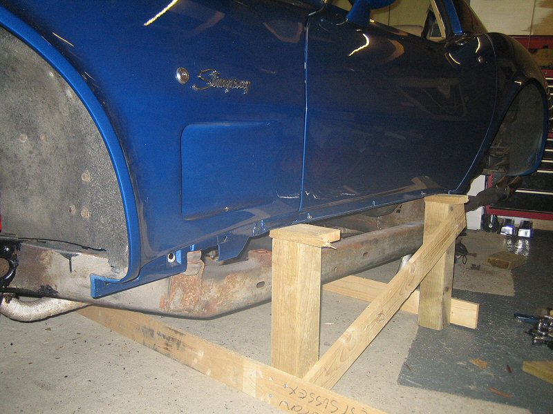

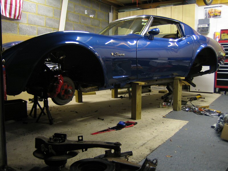

Wash the bodywork and put soft rags between the straps and the outsides of the body to protect the paint. That's how I lifted the freshly-painted body off my '76 and no harm done.

On my 68, I jacked it up, added a lot of support to the body, and then dropped the frame about 10 inches in the back. I dropped it only a couple of inches up where the radiator support panel attaches to the frame (the radiator support attaches to the front crossmember on 69 and up cars). I could have dropped the frame more. This allowed me to clean and paint my entire frame and add new SS gas lines. I did the frame drop and re-install all by myself.
So rather than taking the body off the frame, another option is to drop the frame from the body.

I started this way...
With this method it would be difficult to align the body with the chassis again as you raise the chassis at the end of the job though. At least if the body is hanging on straps you can swing it into position.
