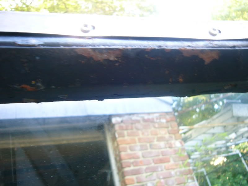

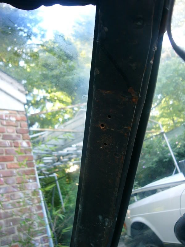

hey folks. Kinda new to the forum here and haven't introduced myself yet. My name is Victor and im 16. We got an '81 around 2 or 3 years ago as a gift from my dad's friend. We are planning on fixing her up this summer. The car is currently blue with a silver interior and my dad's thinking about painting it white and putting in a red interior. I'm 100% against it and want to keep it original, anything i can say to convince him on keeping it original? There's so much info on this forum i don't even have any questions yet. First problem I have is the birdcage, and im not sure how bad it is. Sorry about the crappy pics. Any input is greatly appreciated! Thanks to all.

It's hard to tell form the pics, but, it don't look too bad. Clean it up and you will be able to see more damage (or not), than post more pics. As far as the rebuild, I'm a nut for keeping things original. But if you decide the other, don't throw the orginal parts out. Save them!

I have seen much worse that was fixable. Most of the rust in the upper portions looks to be light surface rust. The body mount seems rough on the right side, but that is an easy replacement. The kick on the left looks like it might need some cut/weld work, but it is in a relatively easy place to get to. Better pics would help, but look into some archived threads and see what has been repaired. Road race vette fixed a hack job that showed how to do it right. The color option will be debated for eternity. Keep it/sell it; original/not- it is your car, do what you want. As an investment, paint it original.

The pass side #2 mount looks pretty bad but is certainly repairable. Vacuum out that rust and see how much damage there is. You might try taking a pick to it to see how soft what is left is, and then you can determine if you need further surgery there.
How are the mounts in front of the rear wheels (behind the inspection plates)?
The top of the windshield frame may need some attention as well. Hard to tell from your pic.
Also, do you have any feel for how solid the rocker channels are?
Welcome and good luck on your project - can't beat free!!!

Looks like you might have caught it early, mine looked similar but when I cleaned them up there was still solid metal behind everything. Hope that is the case here too.

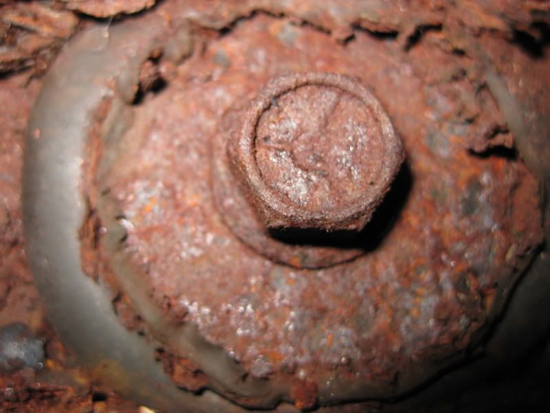

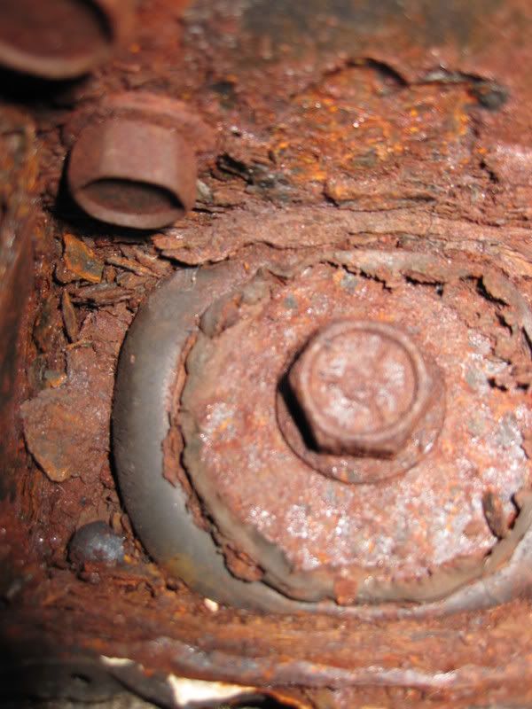

hey guys, finally been sunny so i got to take a few more pics of the cancer. Heres some pics of the kick panels after i vacuumed all the rust out that i could. Also took pics of what i believe are the rocker channels, but only have the passenger side since i couldnt get the screws off the drivers, and what i believe are the mounts in front of the rear wheels. How bad?
kick panel Drivers
kick panel passengers
what i believe is the rocker channel?
Mount behind wheel (drivers)
Mount behind wheel (passengers)
Heres pics of the engine, has anything been "bubba'd"?

Great pics.
- It Looks like the #4 mount on the driver's side will need to be replaced.
- I also suspect that the rust in the pockets (#2 mounts) may need to be addressed.
- The rockers are underneath the fiberglass area that you exposed.
- You should also see how the #3 mounts look - behind the inspection plates in front of the rear wheels. This is in the kick-up area of the frame, which you should also inspect.

It is very hard to see much of the rockers as they are sandwiched between the frame and the fiberglass. The only way to expose them is either by taking the body off the frame, or by cutting the fiberglass (I have seen a few do it this way). Do a quick search on rocker panels - some members have documented their work pretty well.
The #3 mounts are behind the inspection plates in the rear wheel well. They are in front of both of the rear wheels, best to remove the wheel to see in there and use a flashlight.

The rocker channels are actually sandwiched between the fiberglass section that you exposed and the frame rail. You can poke at the exposed metal around the mounting holes for the door sill that you pulled out. From underneath you won't be able to see much but get under there with a good light. The #3 mounts can be seen if you look inside the rear wheel wells at the front side of the wheel well. there is a plate that is bolted over the opening for the mount. Pull the plate to see how those mounts look. I would agree with the accessment that one of the #4 mounts needs to be addressed and probably both of the #2 mounts.
