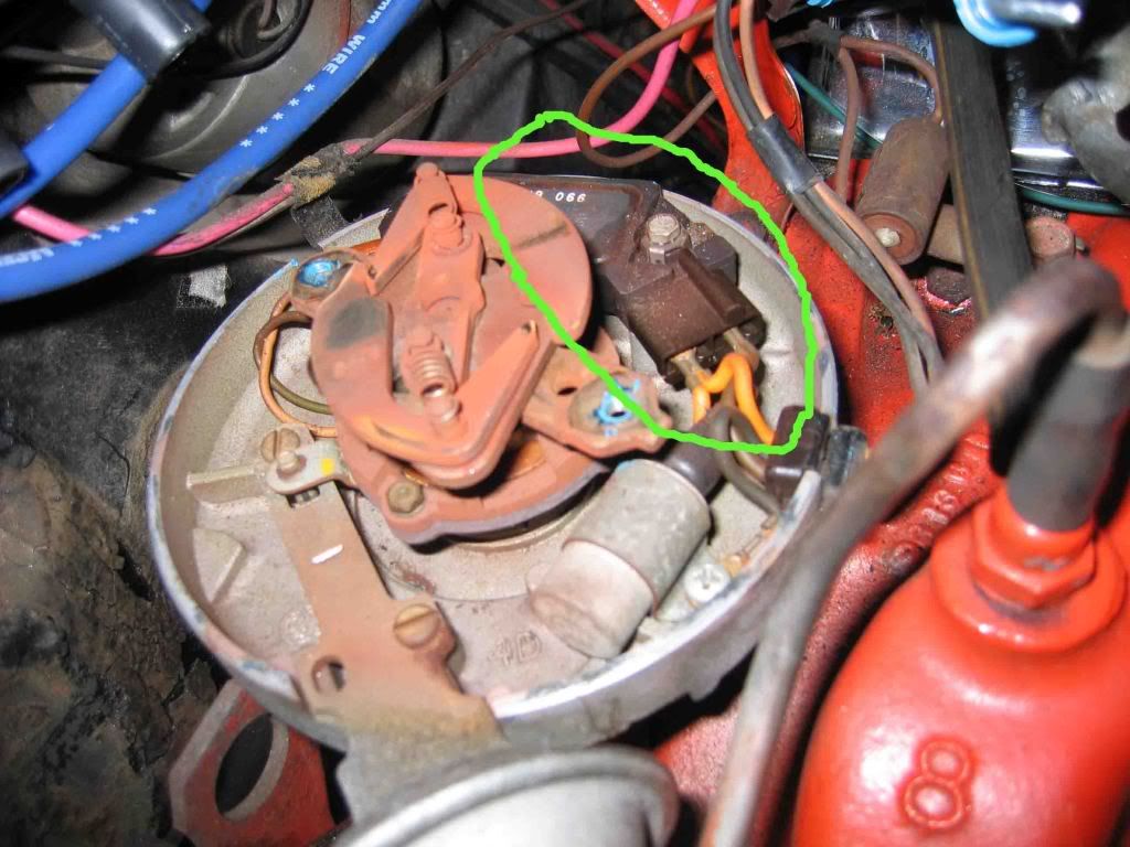

So I was whistling along I-95 in northern Florida in my Orange Flame '76 heading to the airport to catch a flight when the RPMs suddenly dropped out of sight. I coasted to the shoulder and attempted a re-start to no avail. One of those "Now what?" moments. She was getting fuel but no spark- simply would not turn over. I nosed around the distributor before resigning to a missed flight and arranged the dreaded flatbed to drag my sad bumpkin 60 miles back home.

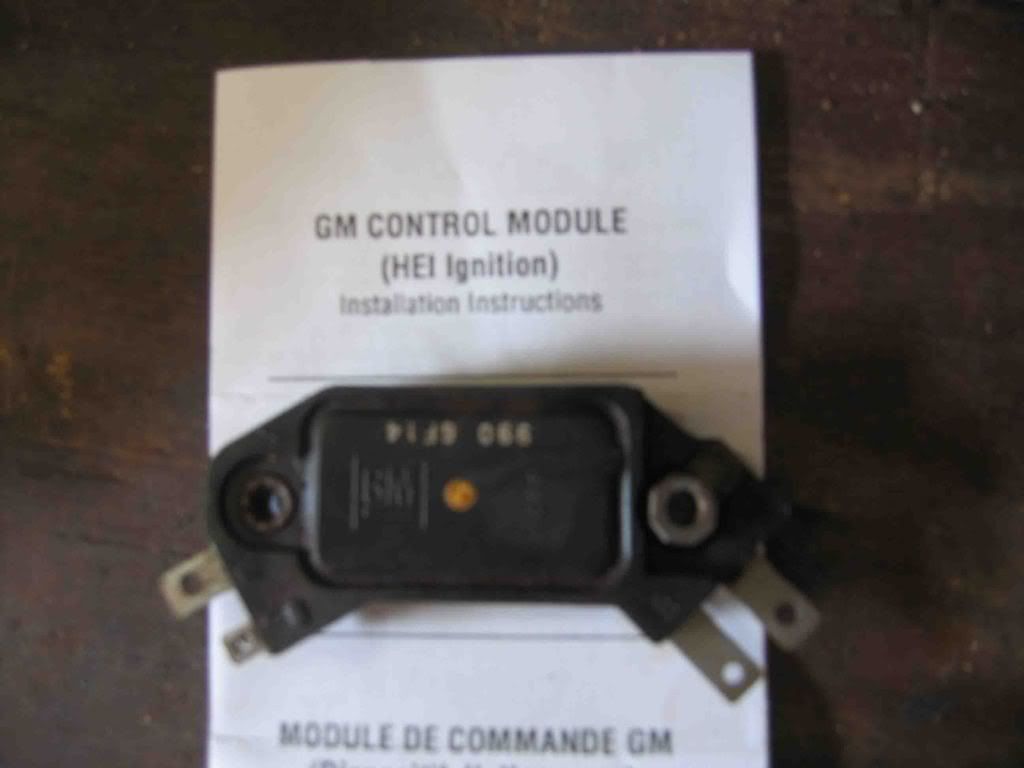

The fix: Deep under the recesses of the rotor sits the control module-
Two bolts, four wire connections, 10 minutes-
Instant start-up.

They have to be installed with di-electric grease on the base. This aids in transferring heat to the distributor base. Normally a little capsule of grease comes with the kit.

Yes, it did come with the small packet of dielectric grease which is smeared on the underside. This 'I will leave you at the side of the road' module is available at your favorite parts store, will run you about $17, and a replacement should have a home in your rear compartment with the socket set and nut drivers.

I bought a spare module a few weeks ago and added to my toolbox.

From the looks of your dizzy, I'd also suggest a good cleanup. That red dust on the mechanical advance is rust!
Add a rotor to your list too. HEI's have been known to blow a hole thru the rotor and put you in the "Walkin' home" mode.

I guess I've just been dealing with HEI's for a while, The module is the VERY FIRST thing I think of when the engine shuts off like someone grabbed the key. The module has a lifespan like a timing belt and O2 sensor. Replacce it BEFORE it goes bad. Every 50-75K works for me. Like you said, cheap insurance.

Thanks for suggesting the clean-up, all that iron oxide dust serves as a conductor producing even more heat in there. Maybe a new hypo dizzy is a consideration...
