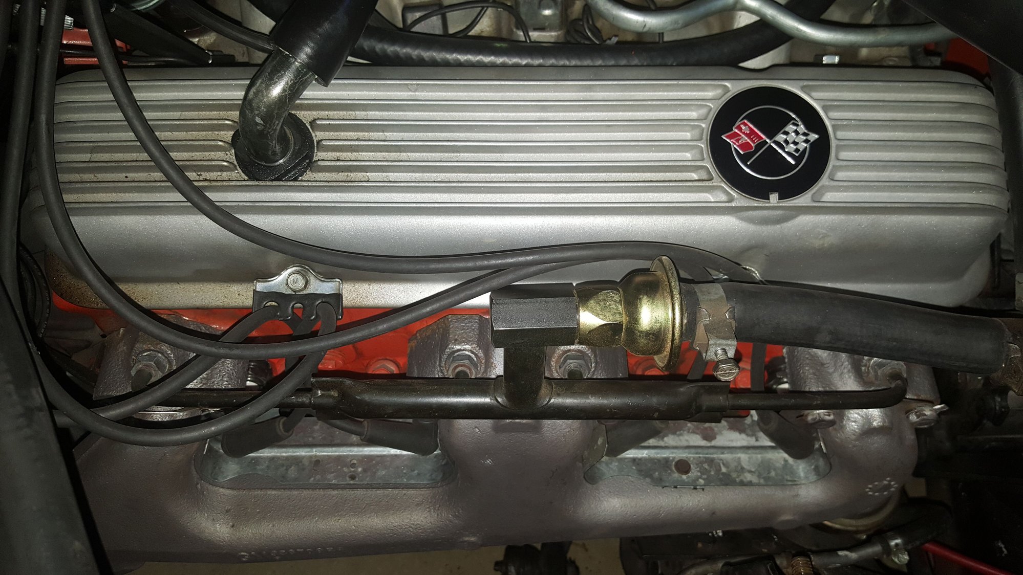

At one time, POR offered a high temp cast iron colored paint. Looks much better than a silver color. Not sure if they still do or not. Eastwood had a cast iron high temp paint as well. You might look into those. I used the POR on my exhaust manifolds years ago and they still look great.
High temp cast iron paint on exhaust manifolds. Still looks good after many years.
