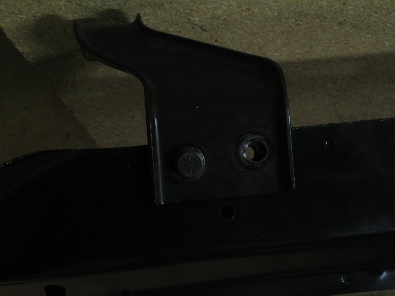

I bought a radiator frame from Ecklers last year for my '76. It has half as many spot welds joining the two stamped pieces as the original one. The edges of the stampings were sharp enough to cut my fingers. (It hadn't been deburred.) The paint finish was nothing like original - it was a thin and glossy enamel. One of the holes for the top shroud support brackets was 1/4" out.
Someone else here in the UK bought the same thing from Ecklers and reported that his was missing the welded nuts to which the shroud brackets attach. Shipping back to the US from the UK is an uneconomical option.
I had to deburr, sandblast and repaint the frame before I was happy to add it to my body-off resto project. That wasn't what I expected with a product from a big-name vendor, but I learnt my lesson and won't use that one again. I just hope it fits the car when I get to that stage.
