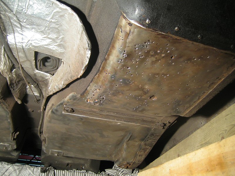

Charles, a guy down here in Sussex lifted the body off his '80, wire brushed and painted the chassis and dropped the body again in a few days. It can be done and would be much more satisfying than trying to reach all the difficult bits with the body on. It would make suspension bush replacement that much easier too.
From the photos in your other thread it looks like a '76. I'm in the middle of a body-off with my '76 (which is the first year with metal floors) and discovered rust in the floorpans that has extended the project considerably. Have you had chance to inspect yours closely yet?
Love the green colour with the black wheels and trim - proper '70s.

Hey all,
I have been under the car a lot and it doesnt seam to be rusted appart from a bit of surface rust...
Thats why i thought that untill i get the money to change all bushings and work on the suspension i would just paint everything to prevent it from rusting now that its in a country where it rains 300 days a year!
Ben UK, it is indeed a 76, and the underfloor looks good...
