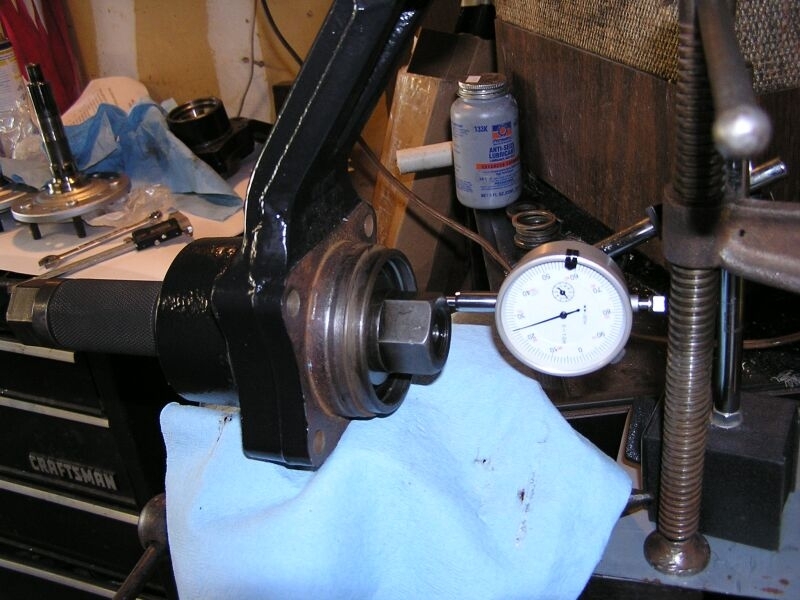

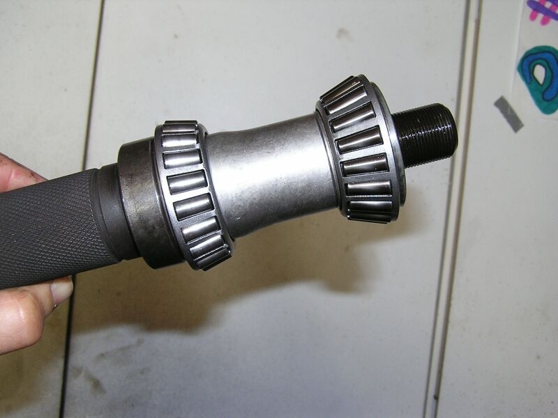

Yes, I have used them. I bought a set from a guy who makes them on eBay. The tools were very well made and less than half the price of the catalogs. Could not have done the job without them.

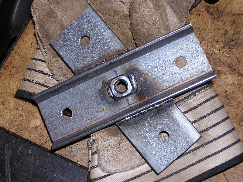

I did make my own removal tool from steel channel.
Purchased Bearing set-up tool:
