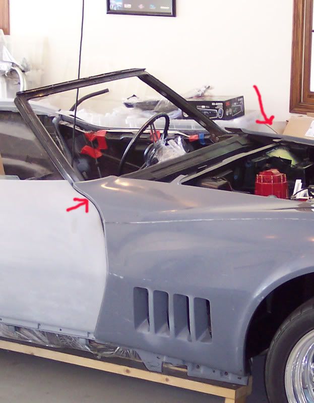

My similar clip had to be trimmed along the door edge I would say a 3/8". There is a step in the new clip at the door edge. Most of that had to come off (see arrow). Have you ground off all the old adhesive from the bonding strips?
Use the drip edge that goes across the wiper door area to line up the clip, that will tell you how much trimming you will have to do. I assume you have most of the drip edge still in place from the old clip as you are supposed to slice it and leave the inner portion bonded when removing the old clip. I also had to take a lot of old bonding material off and then I also had to put in some glass in some areas to build it up where the gap to the bonding strip was to big.
You can see the portion of the drip rail on the new clip. This is how I knew where the clip should be, but you also have to make sure you have the correct distant from the drip rail to the hinge bolts correct per the Ecklers pages.

Eckler's intentionally leaves the trailing edges of the fenders long on their front clips. Other vendors may do the same. The procedure is to dry fit the clip and determine door gaps. Most people use a compass for this; running the pointy end along the door and the pencil end on the fender. Then remove excess material from the rear of the fenders using your pencil mark as a guide.
Easy does it. Try to remove as little material as possible. In this case, too long is better than short. If you're long, you can come back and remove additional material. If you end up short, you will have to add fiberglass.
Dry fit the clip again. Check door gaps and the fenders where you trimmed them. If everything is where you want it, then bond on the clip.

Sabre saw if the excess is a lot. Sander for smaller excesses, fine tuning the fit, and cleaning up the edges.
