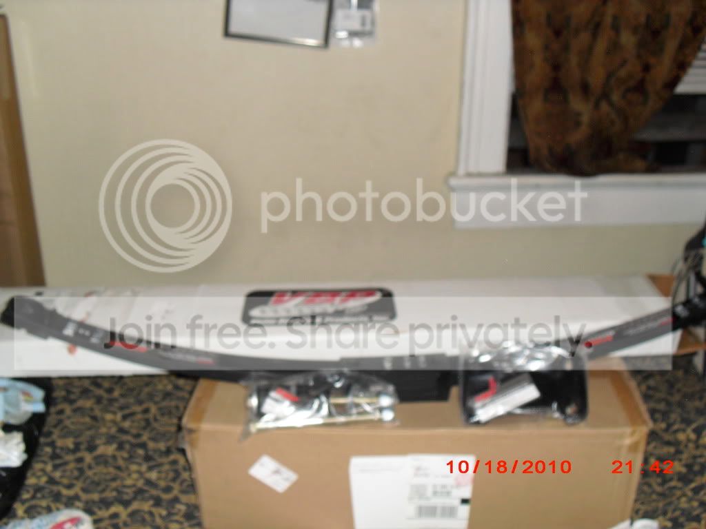

Got my 360# spring from VBP today. I will be putting the suspension back together, if weather permits, and it should be fun. Good looking piece. I hope I install this thing correctly.

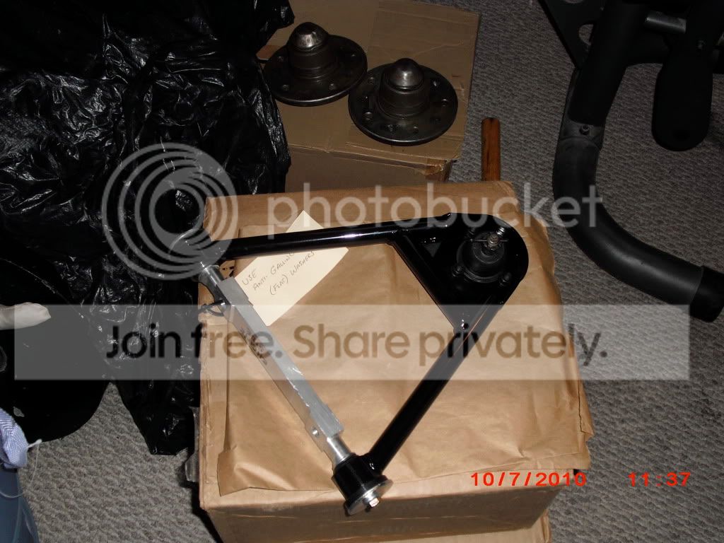

Tubular Control Arms
Front Transverse Monospring kit too(No pic)
http://www.vbandp.com/C2-C3-Corvette...t-1963-82.html
And other new suspension components.

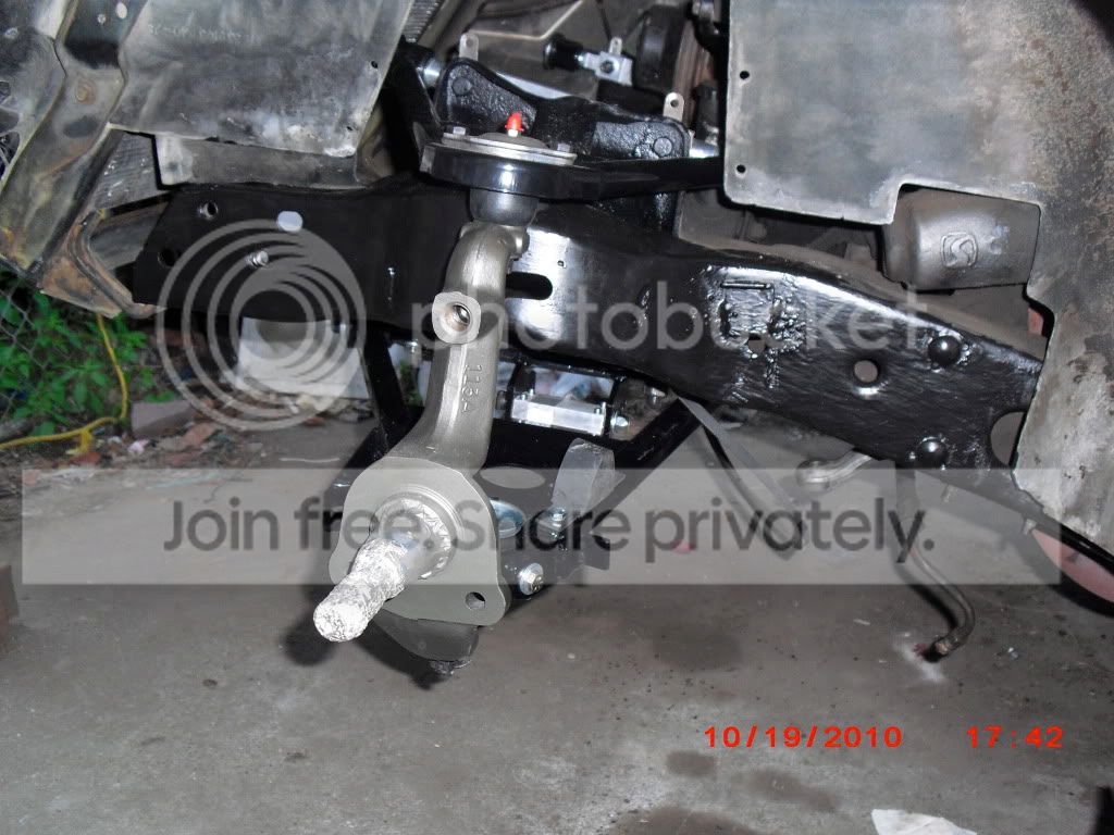

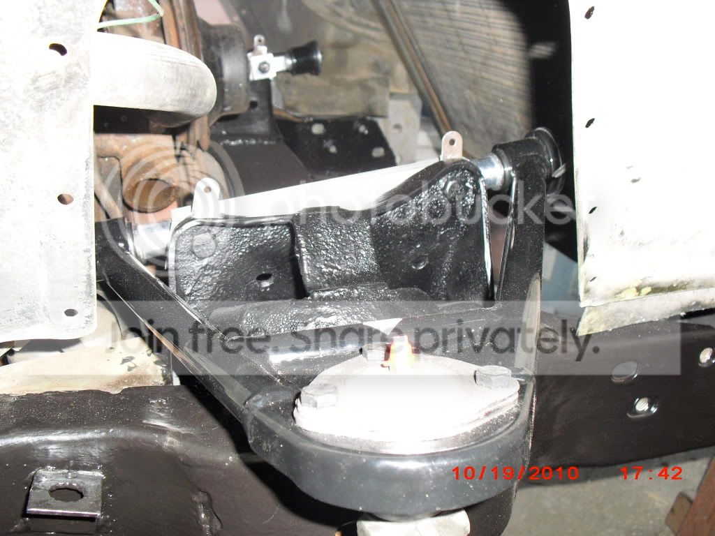

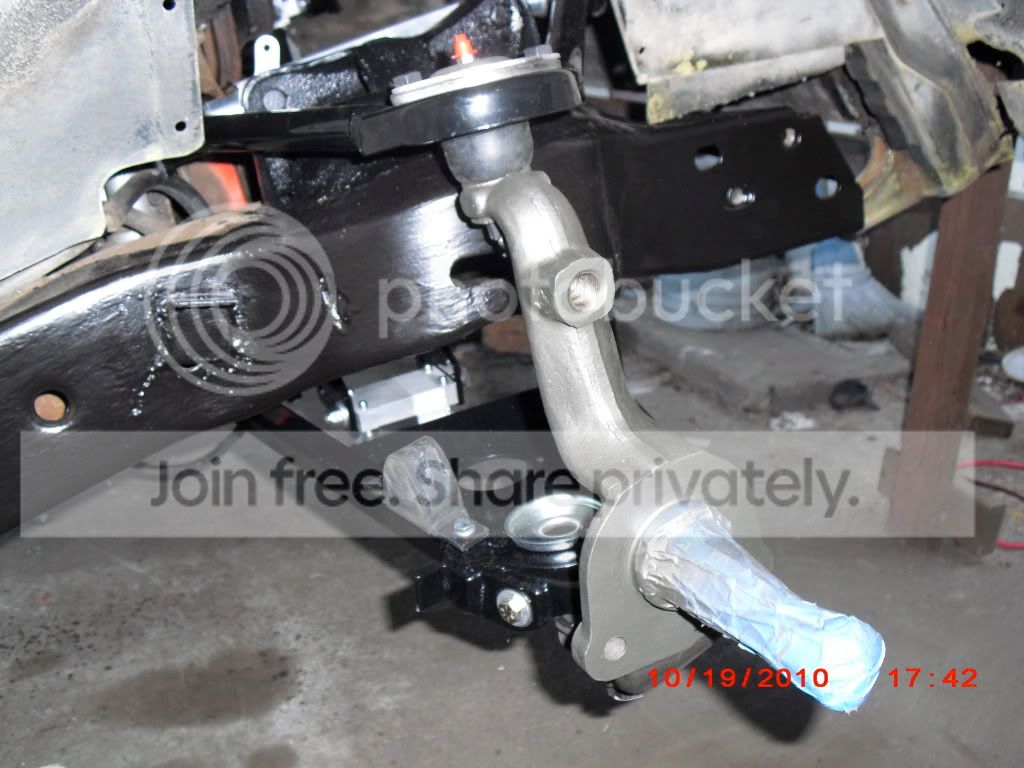

Now I'm having trouble installing the spindle onto the ball joints, especially the lower ball joint. Any suggestions on how to get this thing in?

I'm back from installing the upper and lower control arms. I couldn't get the spindle on their because I had installed the lower control arms upside down, dumb me, and finally figured it out after a search. I'm going to post some pics in a couple of minutes.

Here goes some pics of my progress so far. I'm going to finish the install of the spring tomorrow.
So far so good.
