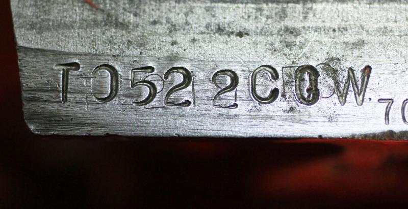

Here is a shot of the number
Old Jan 26, 2011 | 06:30 PM
ahphares's Avatar
ahphares
Joined: Sep 2001
Posts: 153
From: bay city mi
Stamp looks weird,
File or sanding marks at right angle to broach marks.
Phantom numbers under stamp.
Poor allignment of stamped characters.
Andy

Originally Posted by ahphares
Stamp looks weird,
Andy
yeah i see what your saying. I can kinda see the ghost of what could be another set of numbers. I may take some paint thinner and clean it out. It doesnt really matter cause i dont have the car it came in, I was just curious. The guy i got it from had it in a 4wd Chevy van.

the numbers don't line up, you can see a little of the previous stamp under and near the letters, the broach marks stop at the start of the pad. And there is paint on the pad and in the letters which means the engine has been out and painted.. so who knows what was done while it was out.. i would guess it was restamped to match a june 1970 corvette it went in at one time.
it also could possibly be a 427.. you should check the stroke and make sure it is 4.00"
interesting life of the motor. was probably a CE engine or another 454 in another car.. was acquired and restamped and put in a 70 corvette, then sold to a guy that put it in a 4wd van, then sold to you.. thats the minimum, it might have had more owners and been in more cars..
Yes definitly interesting life, I have owned it for two years and never thought to decode the pad number. The guy before me had it in the 4wd van for more than 10 years. if I run my finger over the pad I can feel where it was ground down. I cleaned it up with some paint thinner.

Great photo work on the phamtom stamp! I think you have started to unravel the mystery
Andy
