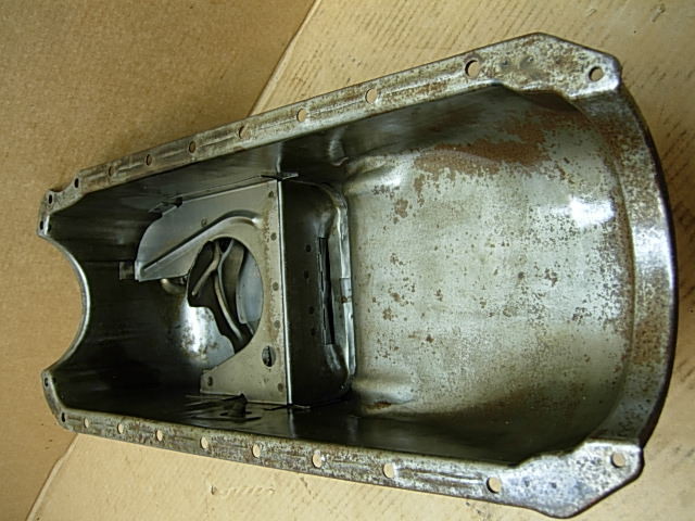

Oil dipstick for 1968 427 is 18-3/8 inches from end to bottom of the cap.
The tube is 13-5/8 inches from the top of the oil pan tube (expanded ring on dipstick tube) to the top of the dipstick tube.
Be sure the tube goes into the oil pan on the passenger side. It does not go into the block of a big block. Does your oil pan look like this? You can see the tube coming in the passenger side in the picture. One possibility is that your baffle in the bottom has the hole blocked so the dipstick doesn't go through, or your windage tray is in wrong and deflects the dipstick from going down into the oil.
But if you have 8 quarts in there, and run it, odds are you will have this whipped mess in no time and have it running out everywhere. And you could get oil starvation in areas due to too much air in the oil from whipping from the crank.

Now if you dump the oil in and then check the dipstick, it will often look empty. It seems like it can take forever for the oil to flow down to the pan in a big block.
Make sure your pan doesn't look something like this.
