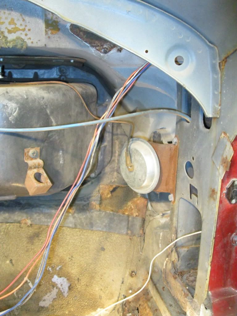

I bought it for 3k, so far i've completely stripped the inside. I will post some underneath pictures later. OEM is not really my main concern. I am very handy with tools so i think i will be able to do most the work, except the engine, on my own. It does run, sounds great, but i have not drove it, one of the tires is flat, and i want to get the breaks checked.

make sure you check out the sticky at the top of the forum for Brakes.. they have a life of their own... and baffel many lol
when you check for rust under the car get a little inspection mirror and light to see if you can see above the frame gusset in the corner just to the rear of the door( there is a corner their that tends to collect debris and rust out a critical structural point) right before the frame kicks up over the rear tires
Need for frame repair will dictate the nessesity to do a frame off (which isn't as bad as you might think if you have a little room)
Old Mar 13, 2011 | 06:22 PM
codeman1330's Avatar
codeman1330
8th Gear
Joined: Mar 2011
Posts: 8
From: Zanesville OH
Old Mar 13, 2011 | 08:49 PM
chstitans42's Avatar
chstitans42
TheCorvetteBen
Joined: Feb 2007
Posts: 4,987
Likes: 144
From: Van Alstyne, TX
Looks like you are coming right along! Let me know if you are in need of any little interior bits. I have been parting out a 76 Corvette, and might have just what you are looking for
