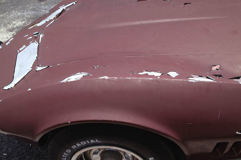

Well, at long last, I've gotten pictures. You'd think my driveway was halfway across the country, eh? Work, work, work... :-)
Here are shots of various parts of the car showing various views of layers on it.
My original concern

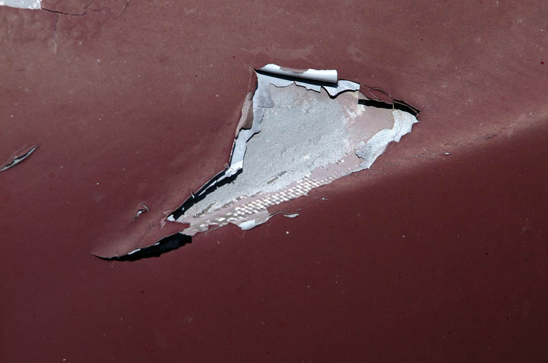

Compared with fewer layers here down near the lights. You can't see it in this shot, but this grey is all fuzzy with fiberglass hairs

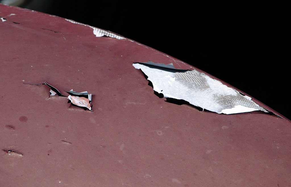

Another view of the front fender. This shows some cracking along the edge that concerns me.

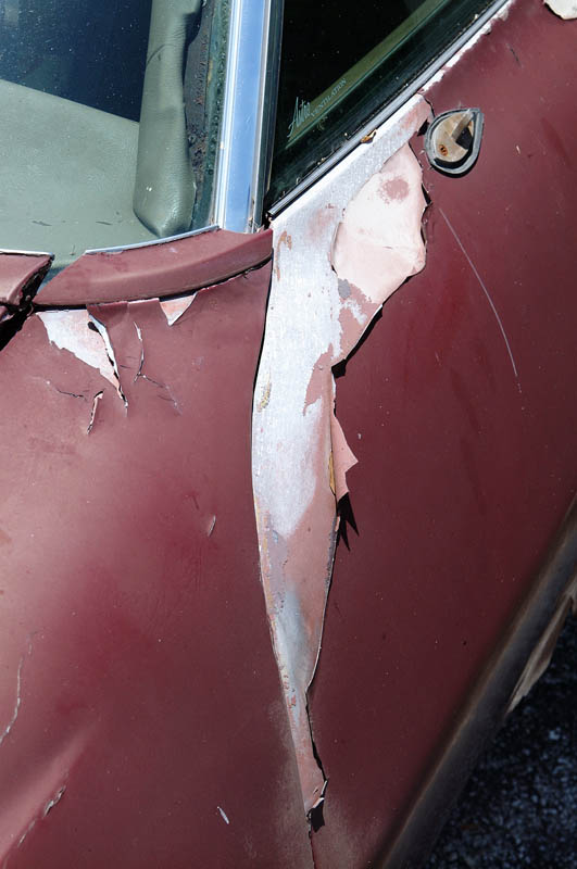

The right fender, near the windshield. You can see fully FIVE layers of coatings here.

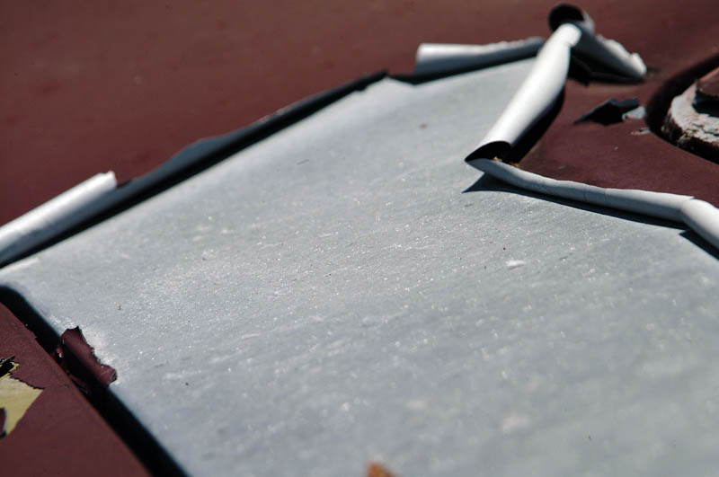

Right rear quarter, near the roof join. Also shows about 5-6 layers.

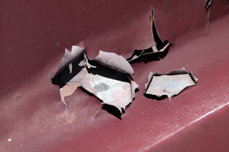

Left door, also 5 separate layers visible.

hit that with a power sprayer and you could shave days off sanding that one (and about 100 lbs in weight :-) ) . that looks like someone has repaired the body and never prepped it befor painting it. and looks like a few layers of paint.

All the fiberlass cloth areas (crosshatch pattern) indicate repair work. Fiberglass matte should have been used.
The bare gray areas might be factory primer, but one or two look like bare fiberglass.
I don't want to rain on your parade, but once you have the old red off this car, you can expect to find surprises, probably more than one.
Good luck.

Looks like poor repairs and poor prep before painting.
