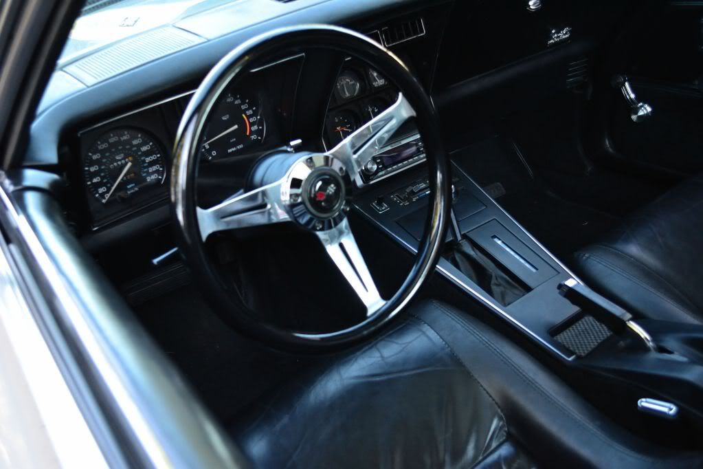

Grant makes some Corvette steering wheels w/ leather 791 or wood 794 that are a direct bolt on.
I put the Grant black leather one on my Corvette a long time ago. It has polished slotted spokes & a very shallow dish which moves it closer to the dash. Nice, direct bolt on about 13 1/2". Ideal.

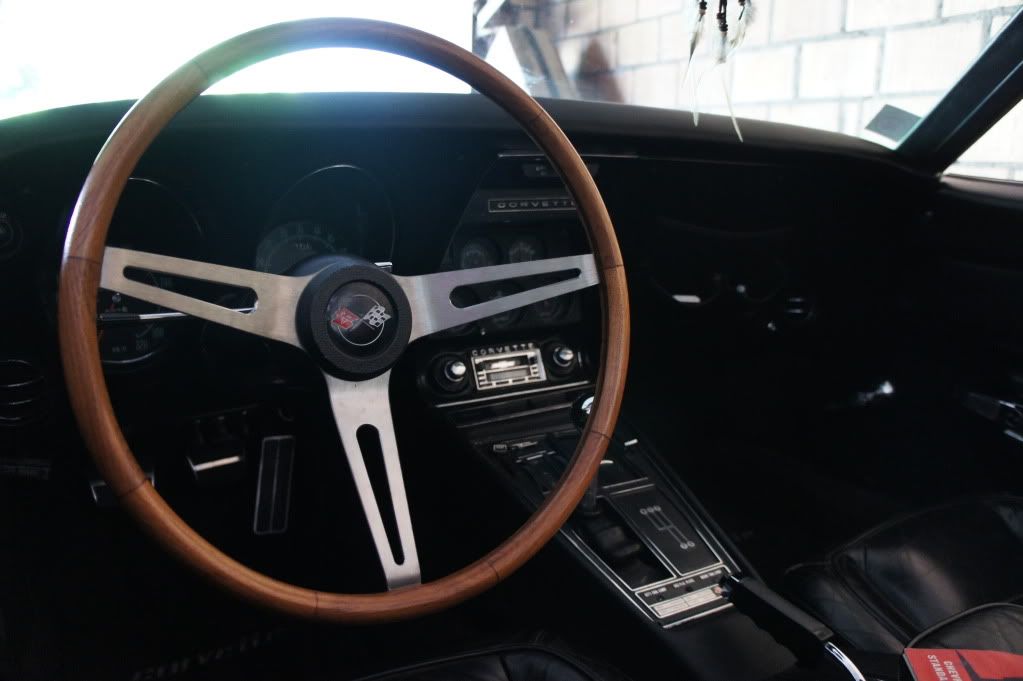

I went with the mahogany version (#794).

thank you for the photo. Can you tell me if the dia. is tha same as the stock wheel. I have small hands, I like the grip of the stock dia.

The grip is definitely 'thicker' than the original wheel, but not excessive - I would consider it comparable to most current production vehicles.

Trae1976, did you have to purchase the Corvette Steering Column Upgrade Kit too?

I purchased an adaptor about 8 years ago, I believe from Eckler's, but it wasn't that kit. The one I got included the textured parts - adaptor cylinder and the ring around the horn button - which sandwich the wheel. The horn button come from Grant.
My installation doesn't allow for the telescoping function, which I didn't use anyway. I replaced the "star screw" with two set screws, and locked it down in the position shown.
I had to drill & tap a small hole in the bottom of the adaptor for the ground wire, but I didn't have to modify any of the original components.

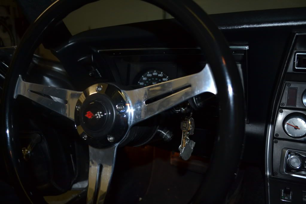

Here is my steering wheel it is a Grant with an adapter, since my 79 doesn't have tilt

[try this one

More info please?
Will it fit T/T column?
Where did you get it?
Any better pic? That pic is kind of dark. Is mahogany or something else?
Looks nice though!

It is mahogany concave not flat spokes. It will fit a TT steering with out the adaptor, you will just screw it instead of your leather one. My Vette had no TT so I had the Vega steering wheel. I got here in Montreal about 150$ . What I love is the feel of the wood. I will try go get you better pictures

here is the link for the grant wheel http://www.jegs.com/webapp/wcs/store...-1&showValue=1
and an other picture

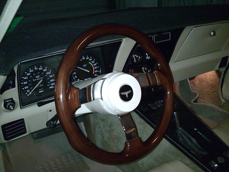

I did this to mine for under $50, does not require any boss kit or adapter, screws directly on to existing column and does not interfere with tilt or tele. I love the feel of the wheel and it looks like it belongs in my opinion.

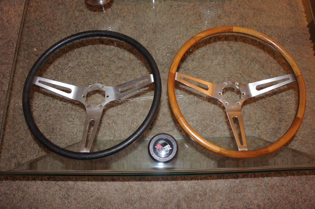

I have to admit I never liked most of the aftermarket steering wheels for the C3. I went for the wood version of the original (even though it was never available back in the day).
