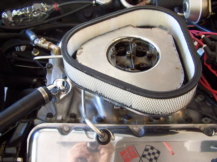

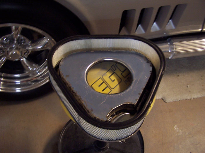

I needed a drop base breather for my 69, and I had always liked the Triangle 427 Breather,
and wanted that style for my BB Holley 4-barrell.
So I bought a cheap 3" Tri-Angle Breather and cut the bottom out, along the seam,
then welded in a 1.5" steel band, dropped the outside shell down,
welded back together, used a bit of seam sealer to smooth and seal everything up !

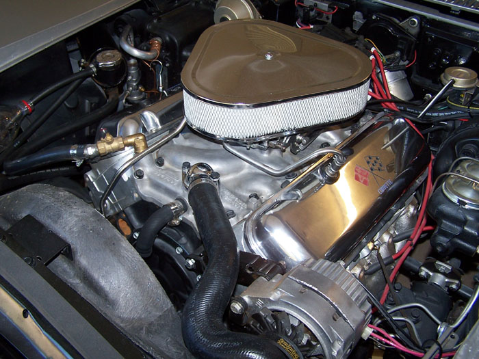

Very nicely done Ssmith! I like your valve covers, in fact the entire engine looks outstanding .
Pete

Very Very Cool I like it
The over flow bottle appears to be a one off too
Great work
Marshal
