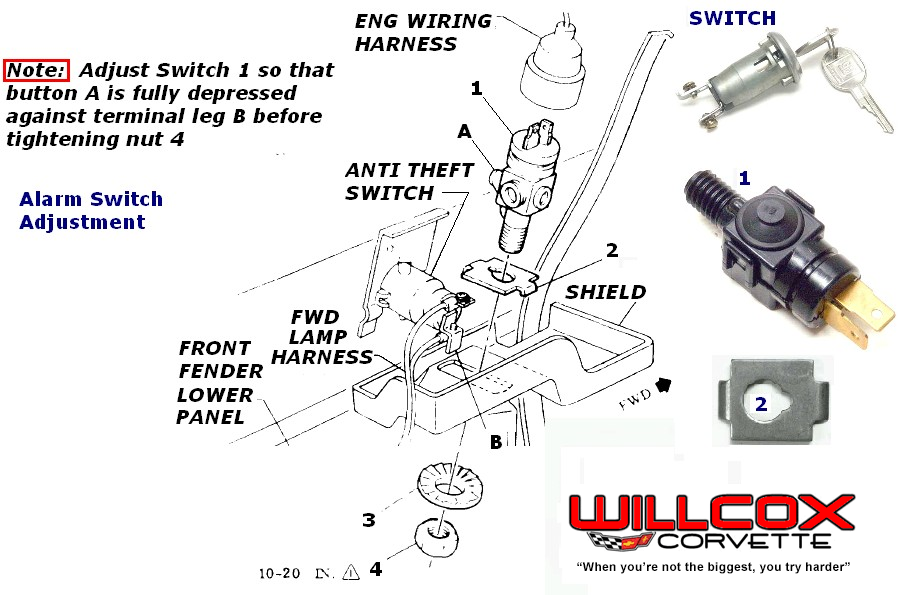

Borrowed from Willcox website tech help link
IT MAY BE THAT YOUR SWITCH IS LOCATED ON THE FRONT DRIVER'S SIDE FENDER ABOVE THE SIDE VENT, I THINK THEY MOVED IT TO THE REAR IN '72. SOMEONE ELSE WILL COME ALONG AND CONFIRM THIS OR CORRECT ME ON IT.

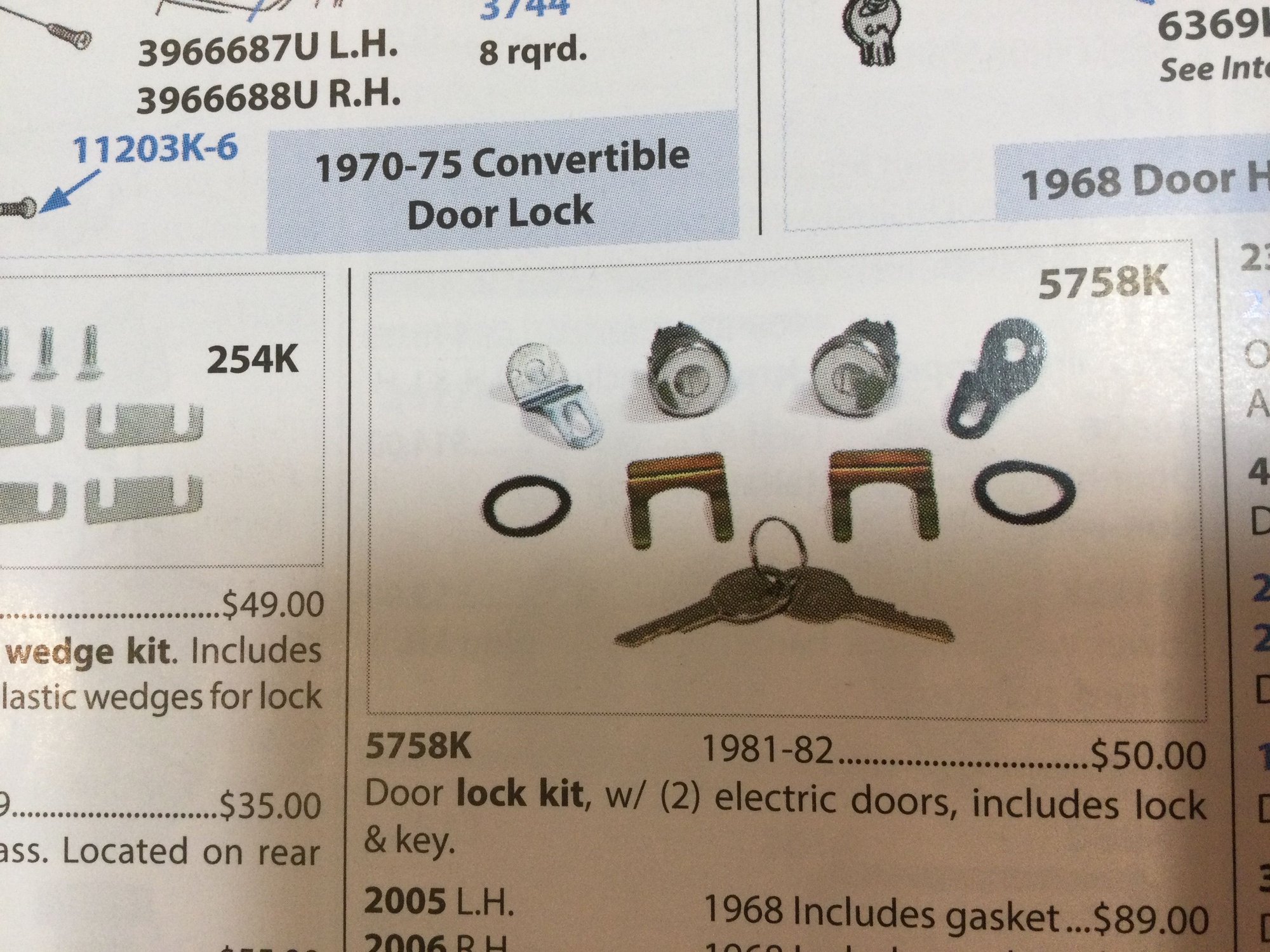

The key switch is hold on the rear body by a “Retainer Clip” you will have to feel with way the opening is facing. I used a smal plastic trim tool to remove it from the key switch. It is the same Clip that is used to hold the door locks on. Google for better pictures. Here is one from a supplier catalog. I am sure one of the vendors has a picture showing the key switch attached. You should not have to remove anything on the rear fascia of the car. Once the clip is removed GENTLY pull it out and you can then disconnect the wires. It doesn’t matter which terminal the wires go to.
The clips are horse shoe shaped, use your finger to find the ridge that you will pull to release it from the key switch.

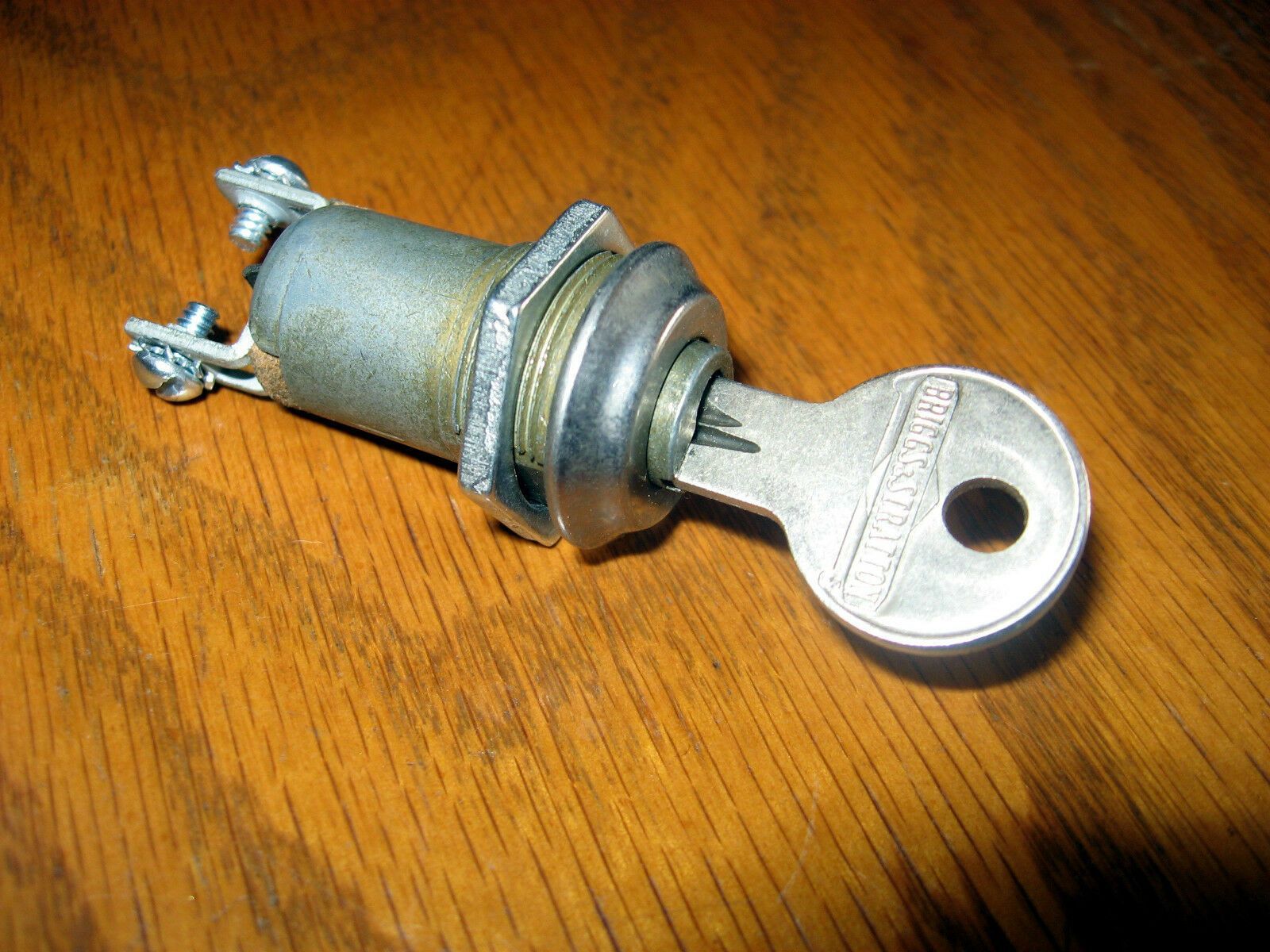

Sorry, the one I need is for a 69 and is held on with a nut. The replacements have what looks like a thin stainless steal washer with them, which mine doesn't have. So I was wondering where the washer goes, inside or outside. Can anyone that has a 68-70 with the factory alarm switch installed, post a picture of theirs?
TIA,
Dan

Here is a photo of the original plate, nut and cylinder. from an earlier Forum post

Thanks PJO.
The alarm switch seems to have been removed before. Probably when it was painted before me. That plate (which shows up in my AIM) is missing. I'm assuming that is what helps keeping the switch from rotating if turning the key too far.The new switch I recieved has a thin SS washer and no plate (https://www.paragoncorvette.com/p-35...ey-switch.aspx).
Thought that it was supposed to go on the outside which would make it look more like a door lock. Looking thru the forum, it seems there is no consensus for what direction the switch is clocked. ie. key horizontal, vertical, which direction to turn on. Maybe it's spelled out in a judging manual? I only want to put it in once.
Thanks

When the alarm is disarmed the key slot is vertical with the teeth of the key facing down, When it is armed you turn the key clockwise then it will be horizontal.I owned a 1969 brand new and remember it well. There is no washer under the switch from the outside of the rear panel.

Thanks Ralph,
That's the way I installed it. I put the supplied washer on the inside against the back of the fiberglass. Turns out the washer was not stainless steel. The plate with the double D hole in it was not on the car..Had to add a block (spacer) on the hood to get the hood switch to work. The rt. door works correctly, but opening the left door does not trigger the alarm. Just wiggled the left switch and the alarm went off. Needs a little cleaning or replaced and all will be good. I love it when a plan comes together!

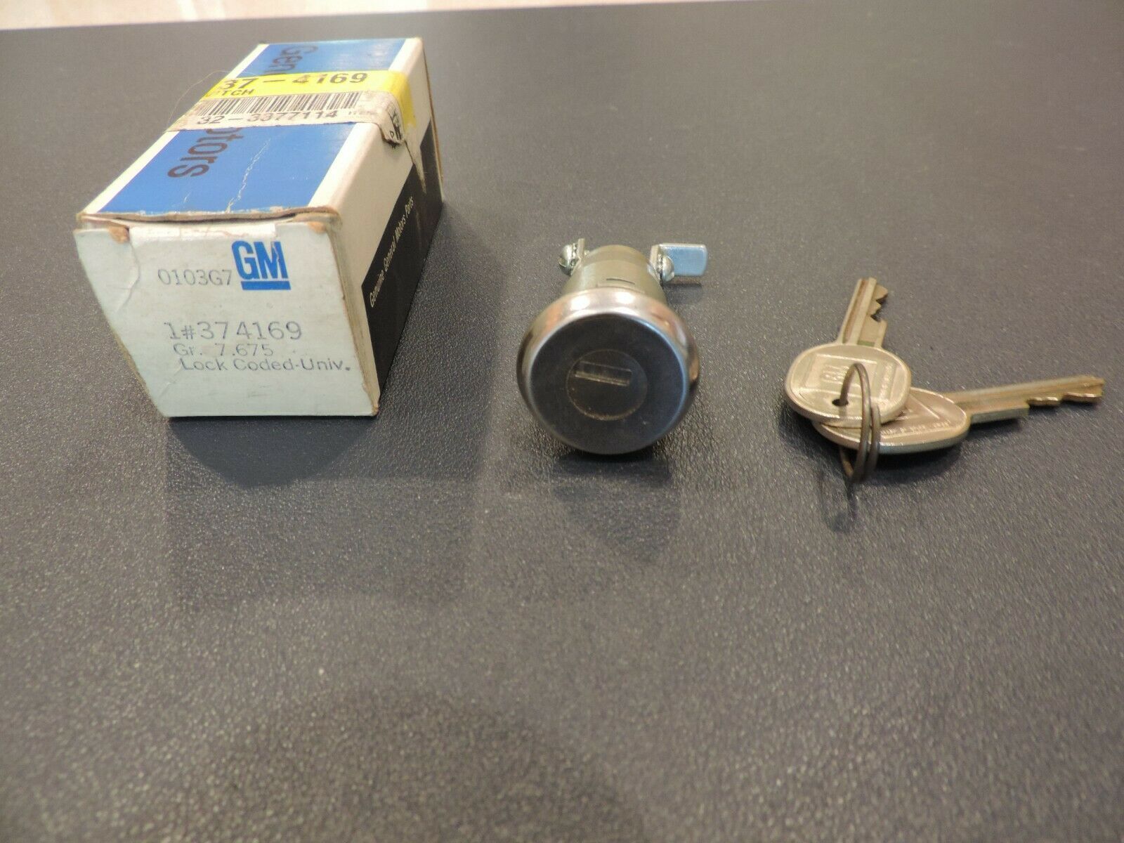

Sorry that was for a 68L-69. Here is the arming cylinder and clip for a 1971 p/n 374169 notice the different cylinder outside cover from 68-69 and later design.
A 1968-69 arm cylinder p/n 3937671

the 374169 switch is for when it was mounted on the left fender the L shaped terminal rested against the tamper switch

Agreed but it is the only option as p/n 3990870 is almost none existent so for service is the 374169. But you still can find the Escutcheon p/n 3897449
