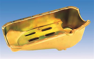

I need a new oil pan for my '72 (with power steering.) I would like a five quart model but can't seem to find a good match - only the four quart versions so far. The standard 5 qt models are to tall in the front and rub the power steering rack. Does anyone have a suggestion or know who makes such a product?
My original was damaged during an engine mount replacement project - my special home made jig slipped. Anyway, any suggestions welcome.

TimAT, I'm looking at the Milodan model 30700, it is a 5 qt pan for a 350 and the specs say it is a match for my corvette - no mention of steering issues. However in talking to the Summit sales guy, he thinks it won't fit because of the thin/thick front gasket issue. I don't see that as a problem. I would like to know if anyone out there has installed the Milodan pan and how it fits. This model pan doesn't have the batwing form, just a deeper sump area in the rear. The front of the pan looks to be shallow enough to miss the steering rack - that is the issue.

I have a Milodon 31503 on the engine in my '72. Fits no problem. I can't remember if it used a thick or thin front gasket, but either way, it doesn't affect the fit.
http://www.milodon.com/oil-pans/stre...ns-sbchevy.asp
Originally Posted by Milodon
Specifically designed for applications that desire improvements over stock yet do not want a high cost racing pan. While appearing stock on the outside, it contains sufficient horizontal baffling to 100% control 5 quarts of oil. Internal mounted windage tray provides increased power yet requires no block mounting to install. Fits all Chevy chassis except 62-67 Nova. A complete low cost performance package. High strength magnetic drain plug included.
Pan fits a 3.750" 400 stroke crank with steel stock rods. Eagle's 400 rods may need slight fitting
Pan Capacity is 5 Quarts Plus Filter - 7 1/2" Sump Depth
A pic of it on my car:

7t2vette, thanks for the picture! That's what I needed to know. I am in the process of ordering one now.
Thanks again!!
