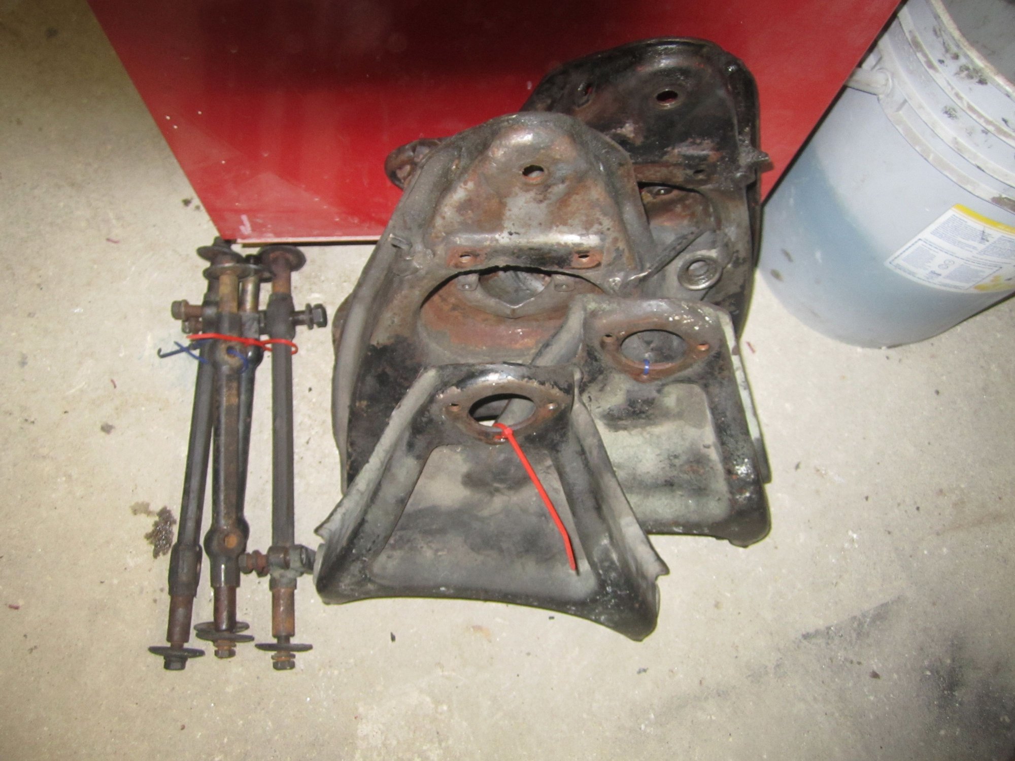

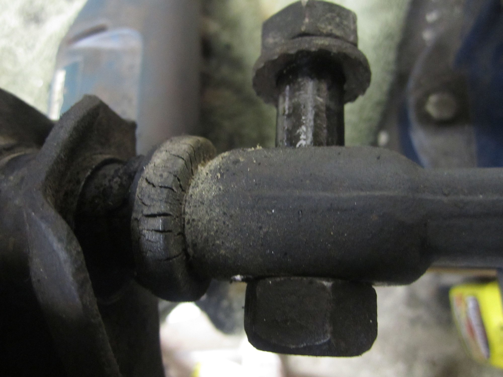

Not for everyone but it's a no-drama way of removing control arm bushings
Hit the areas concerned with some PB blaster for a couple of days when I thought about it, not sure if it helps but certainly doesn't hurt.
Holding the shaft in the vise, removed the bolts and washers to get at the rubber sticking out.
Cut most of the rubber off with an knife to expose some of the inner sleeve

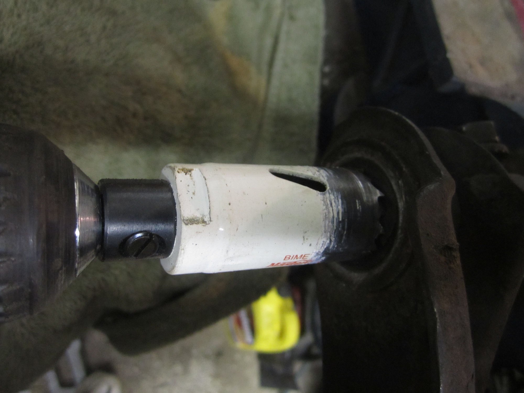

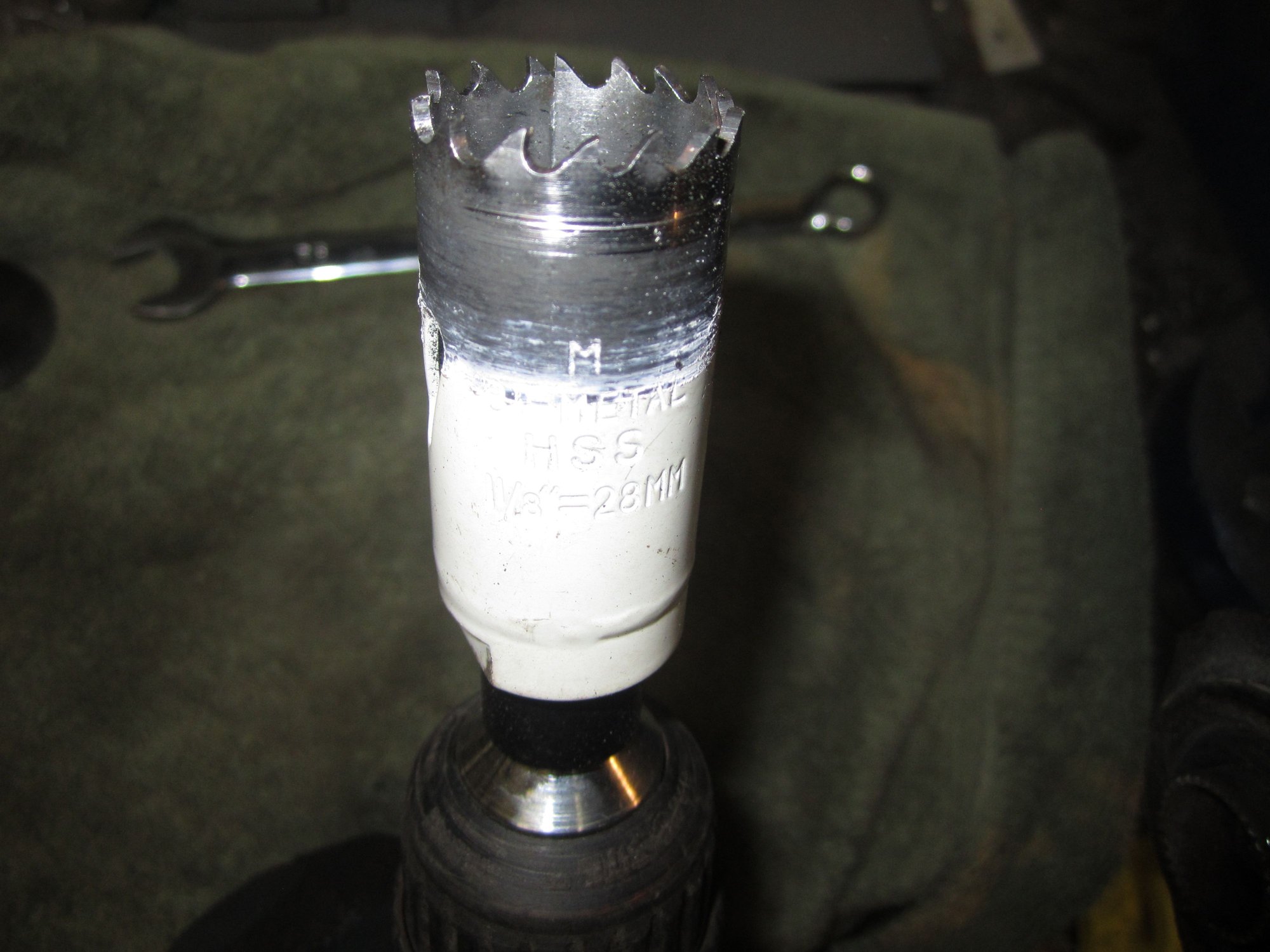

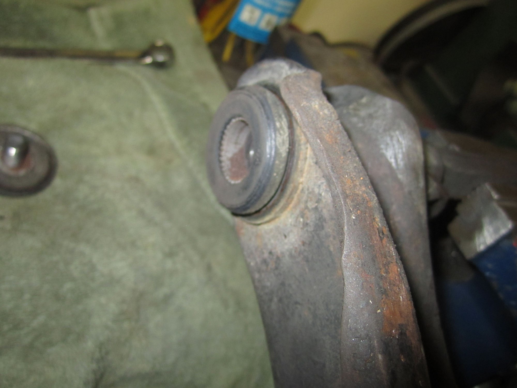

1-1/8 hole saw, take the center drill guide out
Use the inner sleeve as the guide to get started and drill the rubber out. Takes about 20-30 seconds, remember to keep backing the drill out to clear the rubber "chips"
There will be a little ring of rubber left on the inside, when the drill breaks through this is left and helps protect the shaft shoulder from being hit by the drill.
Cut or slip a driver through it and break it off

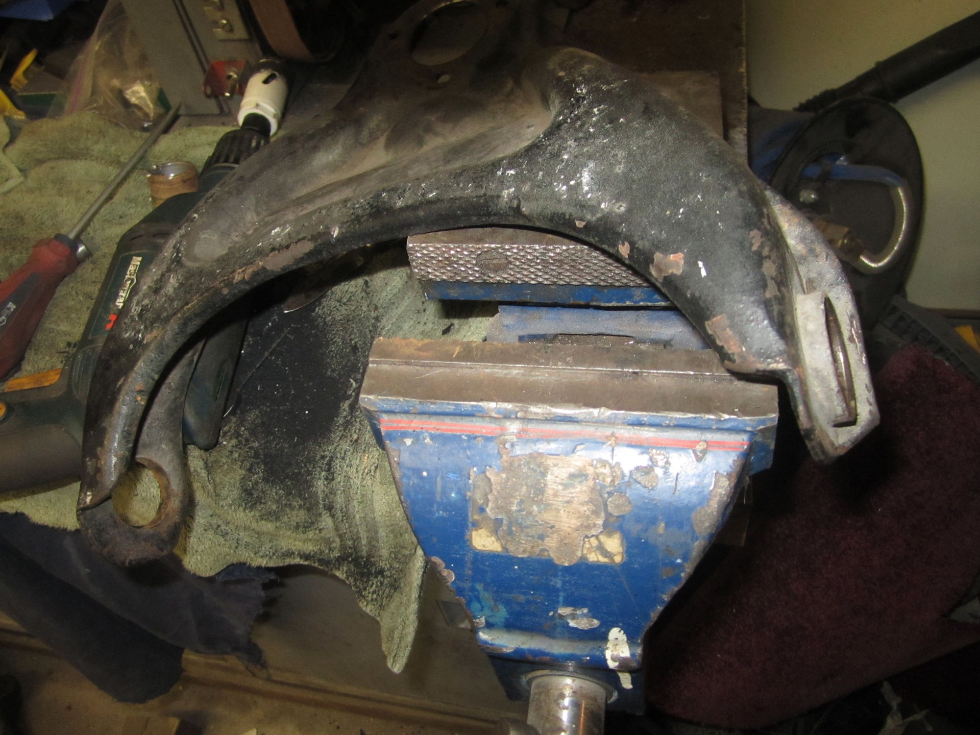

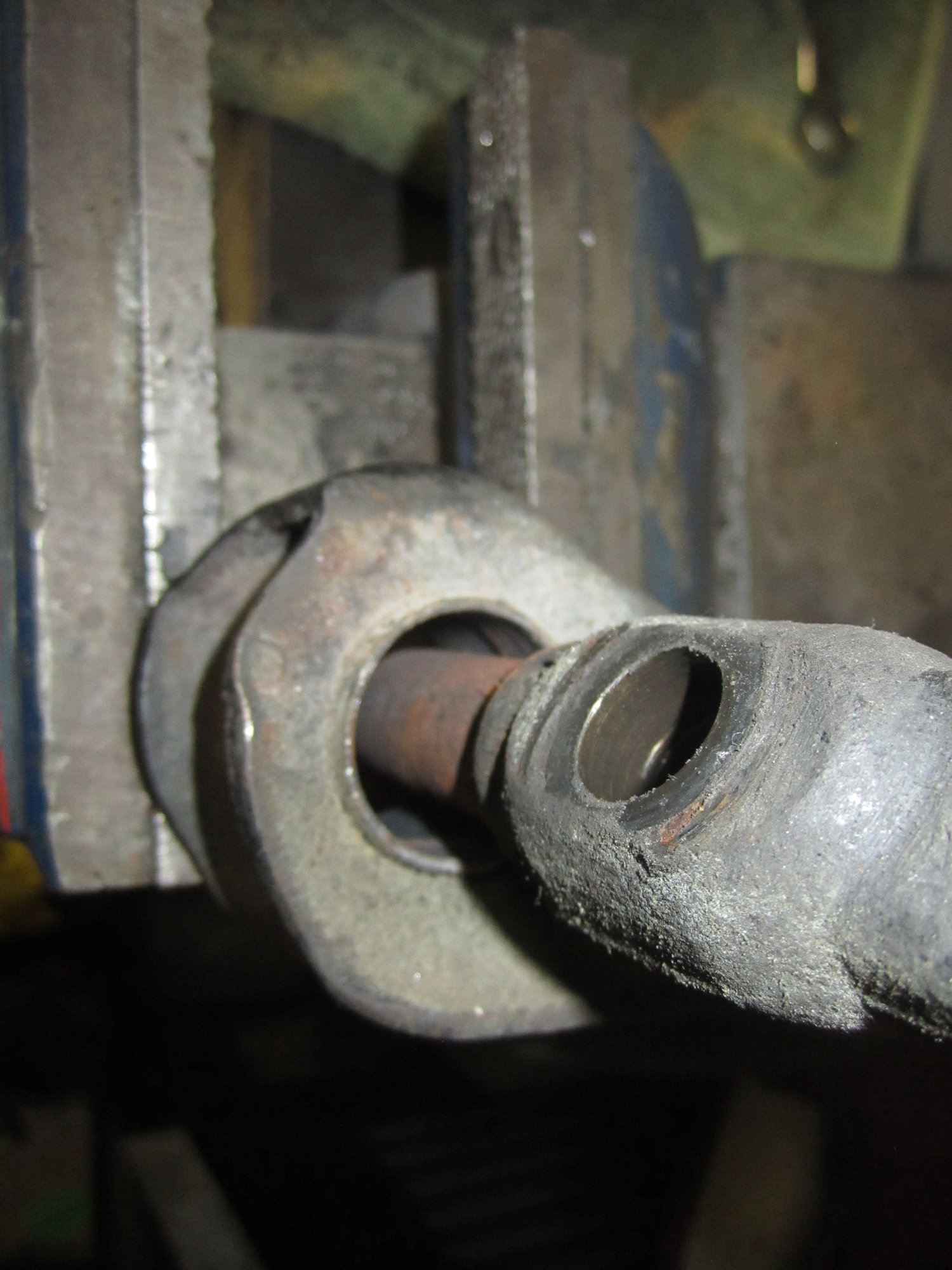

On the lower arm, the inner sleeve sticks out a little, the upper arms are almost flush. To separate them from the shaft, I used a chisel in the gap to loosen them and open them up for removal. These were fairly clean, actually only one shaft was rusted on tight.
The lower arm shafts cannot come out (too long) with the outer part of the bushing still in. I rested the arm on top of the vise with the jaws open slightly larger than the bushing flange (so the arm is actually supported) and hit the inside edge of the bushing where it sticks up about 1/8" with the air chisel and a straight/flat bit. a couple of blips on both sides pushed the bushing down until it was flush on this side
No picture of this (couldn't hold the arm, chisel and camera ) but then I went over to the outside and with a wedge/chisel bit between the bushing flange (now pushed out some) and to top of the arm (where it folds over and is nicely supported) bliped the bushing a little farther out with the air chisel. Now it is far enough out to get the chisel at the flange and push it all the way out of the arm.

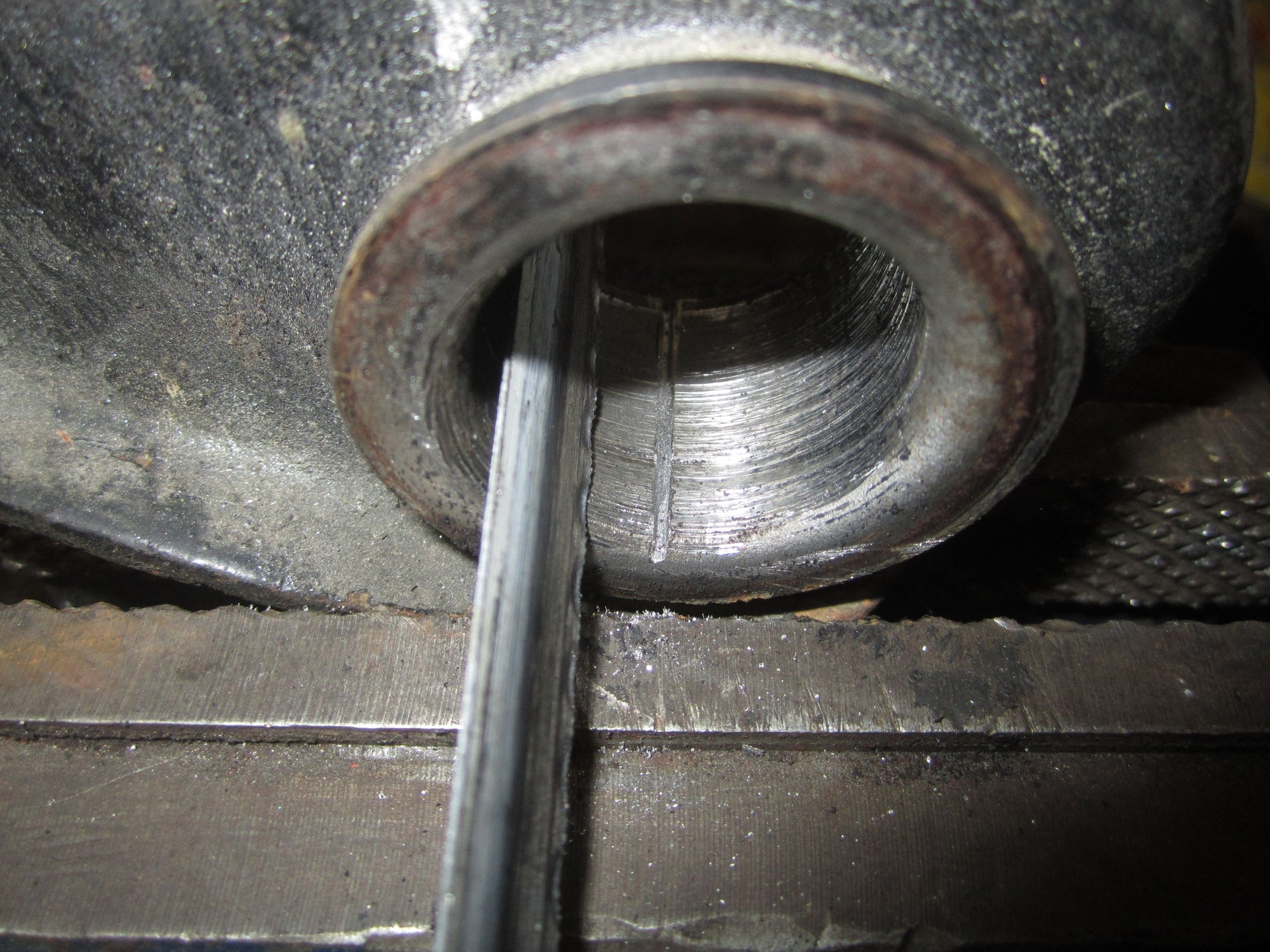

The upper arms, will let you slide the bar out of the bushings (all the way to one side will clear the other side and let it be pulled out)
Took a hacksaw and run the blade inside the bushing and cut a slot part way through the bushing. Didn't go all the way through since I didn't want to risk cutting into the arm. Part way is enough to weaken it anyway.
Hitting the side of the bushing with the chisel a few times beside the cut line will collapse the bushing somewhat and then it drives out easily with the air chisel.
All four arms took about half an hour, including coffee time. Granted mine were not bonded on the molecular level with rust like some I've done before but the process is the same, just more expletives will be needed.
