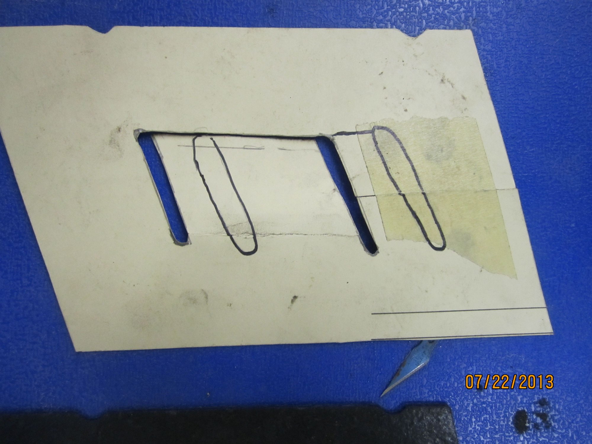

Just closing off the thread
I ended up making a set of seals (used a set of A-Arm flaps, only thing I could find cheaply)
Here's how far I ended up moving the slots for the bracket, the marker shows the location of the slots in the replacement seals, the cut-outs are where I needed them in order to locate the seals over the hole in the inner fender.
New one on the left, purchased on the right
Oddly enough, the small cutout to align the seal is in about the right location, my brackets are sitting high according to the purchased (and the old original seals) but closer to centered in the hole. Go figure
