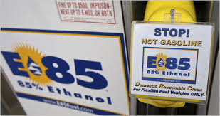

When E15 replaces E10 at the pump, then we should have no problems in our collector cars...right Mike? How about E30? If E10 does not create problems, then what percentage does?
"EPA approved E15 before vehicle testing was complete, and we now know the fuel may cause significant mechanical problems in millions of cars on the road today," said Harry Ng, API vice president and general counsel.
