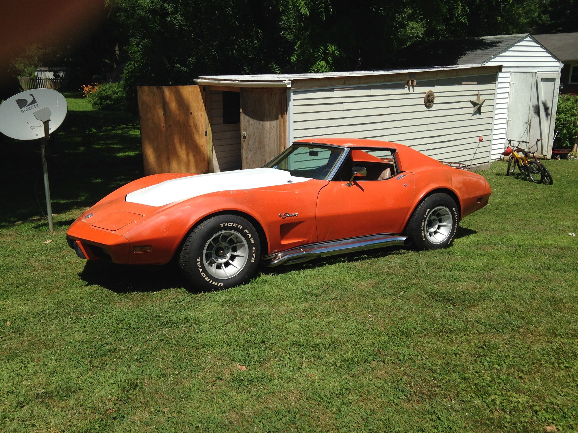

Didn't even need to modify the rockers to install mine. They're from Doug's headers.
Loving the look of your car.

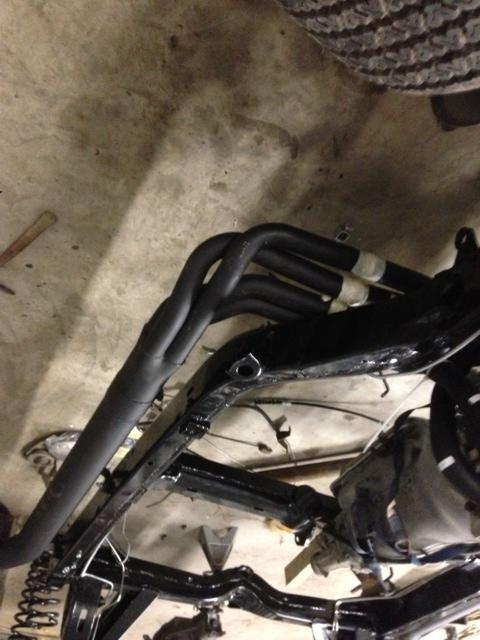

I have installed big block headers and sidepipes on my 76 no problem and no notching. I also did it with jack stands. I did not have to raise my vette 31/2 feet to do it either. Thats crazy. The only spot that is snug, is the pipe next to the steering box. About 3/8" clearance. Do it yourself and safe some money for other stuff.
Love the way you did the back and hood. I have been toying with some type of stripe but did not want racing stripes. I may steal this idea. Mine will be a Dark Navy Blue (Huntington Blue) with a white stripe.
Is the back off of a 78? I would like to add the spoiler as well and have read that the pre-molded spoiler on a 78 will fit the back of a 76.
Great Looking vette.
