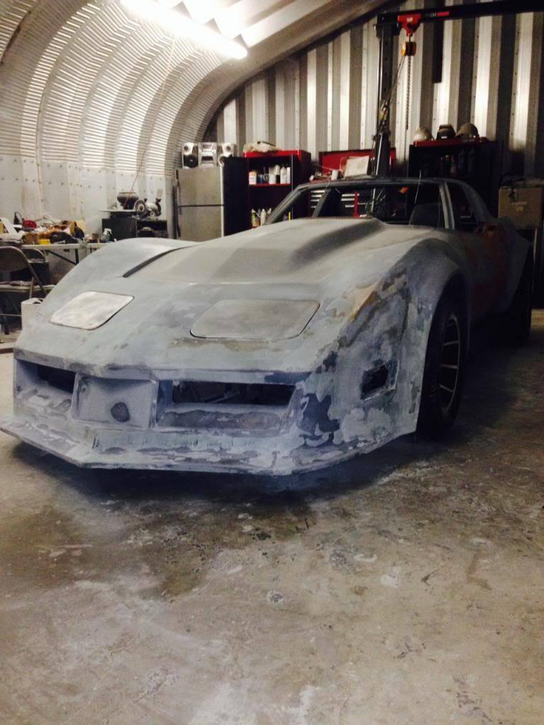

I have a 78-81 daytona front on my 73, it takes some work but can be done.

Originally Posted by qwank
Any nose besides the correct nose is going to look funny on a '73
This is your opinion.. Some of us like the modified look....
I like your nose the best, I just like it on '74 and up. or on a '73 with the rear chrome bumpers removed i guess, but he's probably not going to go that deep into it.
Yes it is a lot of work getting them to fit to the flares. I'm not sure If I'm going to put the rear bumpers on yet. I have them back from the chrome shop but sure they would be easy to sell. Once I get a coat of primer on the car I will put them on and make that decision.
