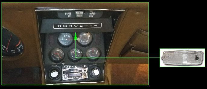

I am currently restoring the interior in my 72 vette. Working my way up from the emergency brake forward...cleaning, fixing, painting and polishing. I am looking at this little piece that holds the wiper controls and has a little slot on it that looks like it was suppose to be used as a vent for this plastic duct piece that connects to the main air duct (actually it's just hanging on by a thread right now and I don't see how any air could had gotten into that thing and out that slot). So, I was thinking that I would just take that duct out and patch the hole in the main duct. And I was thinking of installing a little map light in the area where that slot is (mainly because the car only has a little light in the back that would be considered an interior light. Has anyone ever done this before? If so, do you have any advice? I would like to install some type of light that has a built in switch to it or one that you push on and off. I have a 1980 MGB that has a little dome light in it's console that you toggle front and back to turn on...I think something similiar to that would work. Any ideas or advise would be super awesome!! Thanks!

Originally Posted by shell2172
light idea??
this is what the dash looks like....is it possible to install a light mounted flat above the gauges and facing downward?

Your car should also have courtesy lights mounted under the dash in each footwell. The driver side courtesy light mounts into the same bracket that holds the hood pull handle, the passenger side courtesy light mounts to a bracket that attaches to the screw on the upper forward corner of the kick panel.

Have you considered a short strip of LED's? Something like this: http://shop.advanceautoparts.com/p/a...searchTerm=led

Here's a $20 solution- that doesn't require hacking up your bezel!!!
Use a COB LED - about $20- and surface mount it- you can locate the switch under the dash- and this light pulls very little power.
I'm using them for my turn signals-
Pretty bright- and this is running a 9v battery-
To installing a map light in the wiper bezel?
I have a small LED tube mounted under the wiper control- double sided taped.
I also put 2 movable LED spot lights in the small recess where the T Tops
clip in.
Seems to work OK.
Cheers from a cold Melbourne, Australia !!!
