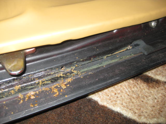

I remember it was a great "joy" to get the old glue off the tops
Even with the help of the dog I needed hours
