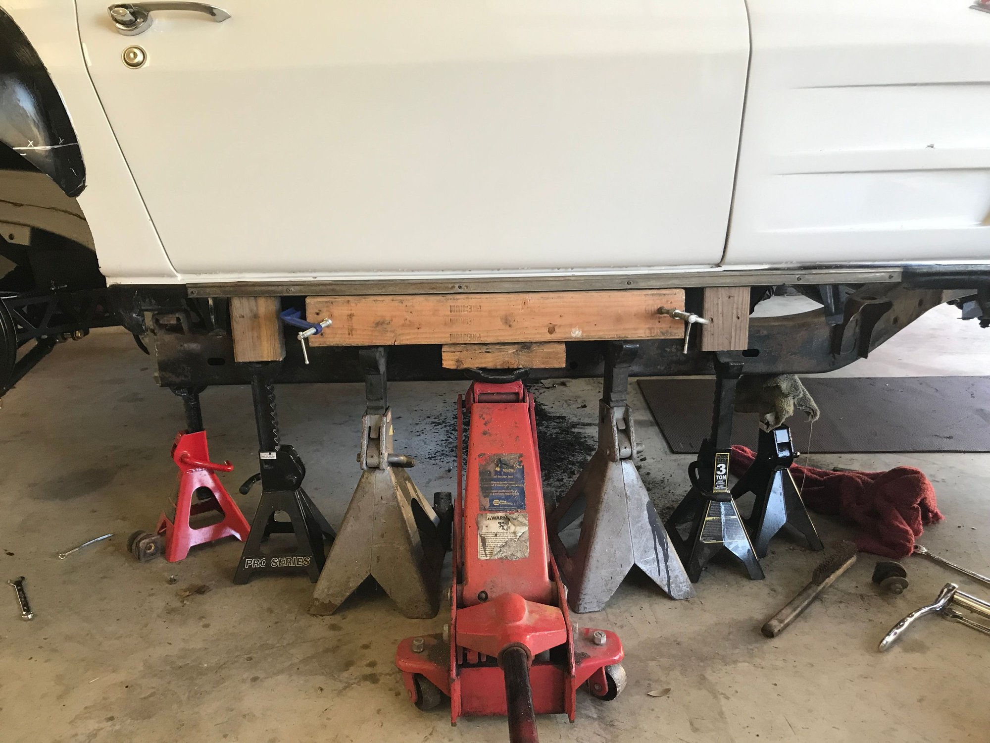

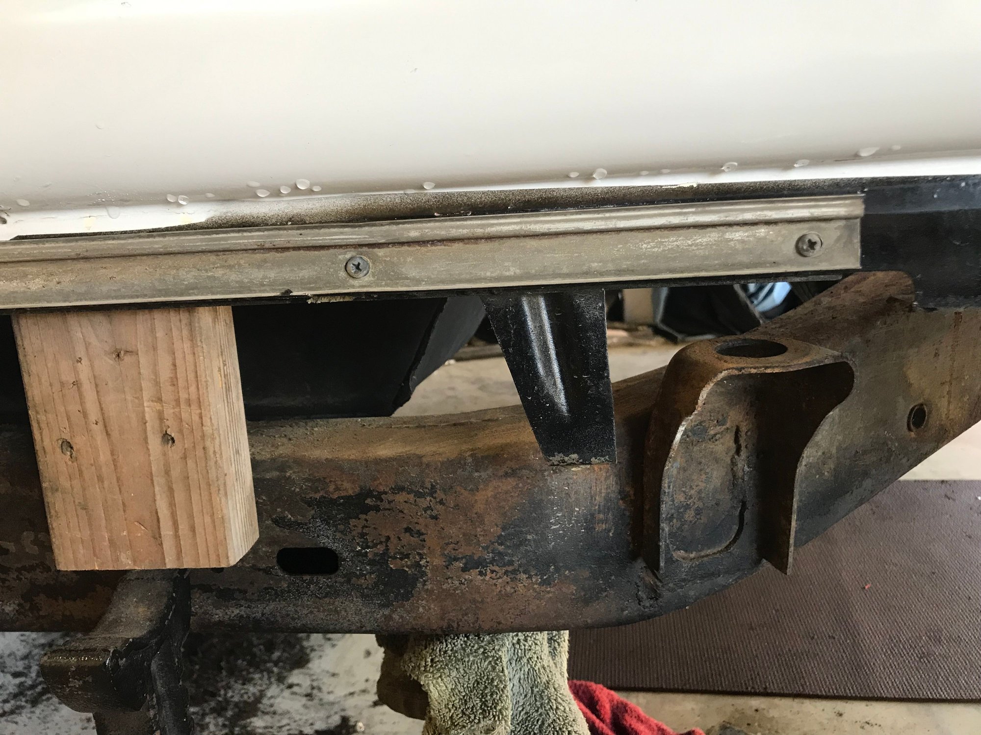

This is my C2 (1964), but same concept.
Yeah, I was a little paranoid about a Jack stand slipping!
I went up about 6” so I could get in there to clean, inspect and paint the frame.

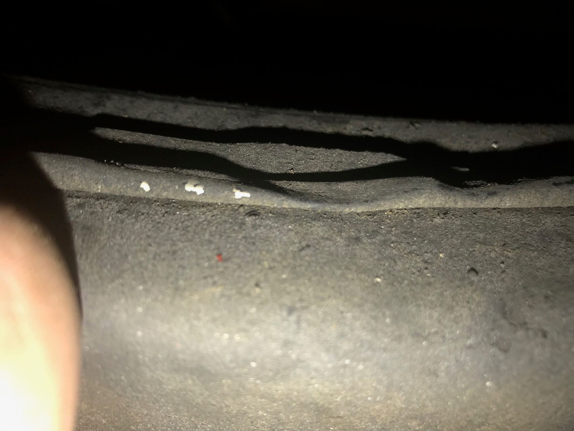

Glad I did as I discovered this, my rear brake line completely crushed. I replaced it and the fuel lines “while I was in there”.
