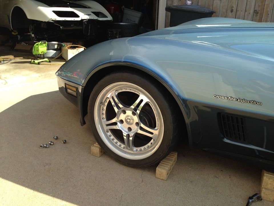

Take a look at these, I got bored today so I thought I would play around with some HRE's that I have had in storage for years, these are for a 98 Firebird, so the backspacing, etc is not correct. But I decided to "mock them up" just to see what they would look like on a C3. They look better than I envisioned them, but curious to hear other opinions...
PS- HRE doesn't make these anymore, they are "547's". But CCW makes some that look just like them, and look just as good if not better, for half the price....

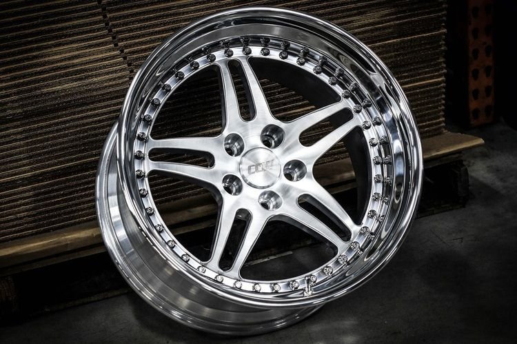

Here is CCW's "equivalent" to the HRE wheels shown, they call theirs the "505":
And with all the positive responses it looks like I have made my decision on what to order....

Here are the dimensions I have so far:
Front: 17" x 8" with 4" backspace
Rear: 18" x 10" with 5" backspace

IMHO the CCWs are going to look better on your beautiful blue 'vette than would that particular HRE.
You might also take a look at 5.5" BS out back so that you're not pushing the wheel width out a full inch further than stock, and to possibly consider 8.5" or 9" with 4.5" BS up front. ...pending tire fitments.

yes, will do. Thanks for the backspace dimensions. That was my hidden agenda was to flush out some backspace numbers from you guys.
