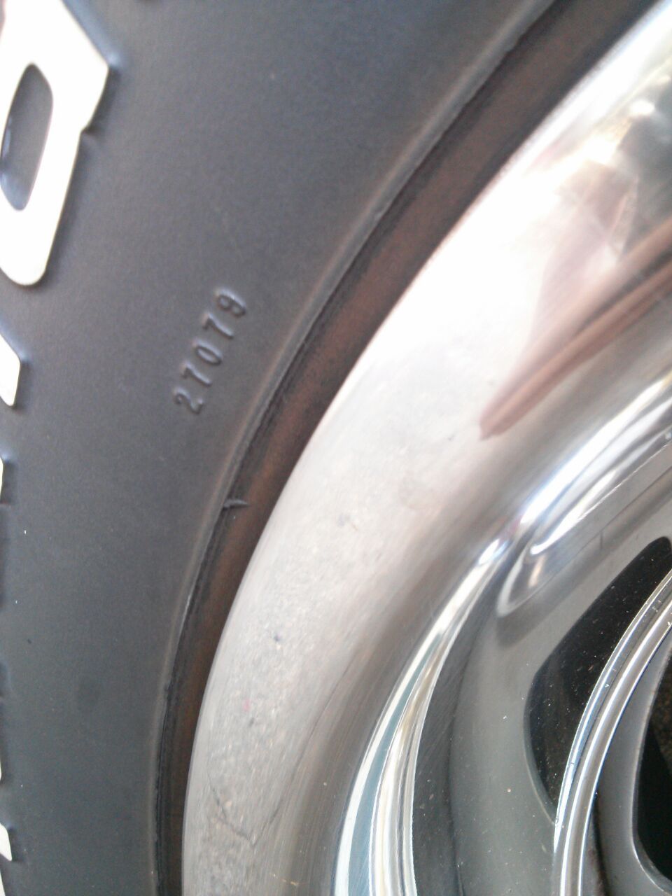

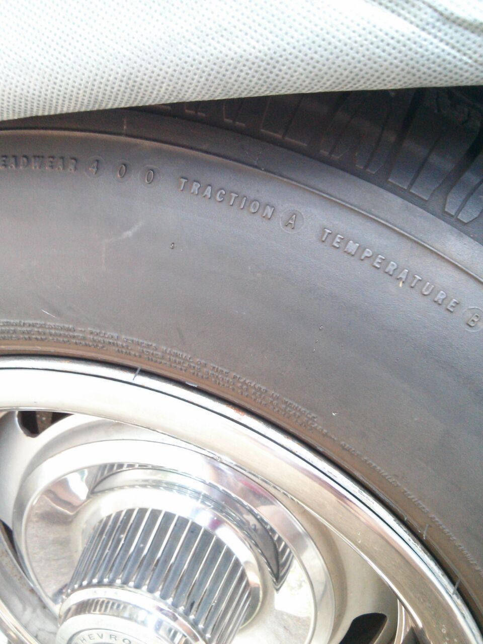

Hey all,
I posted on here about a month ago asking for advice before taking my new '72 on a cross-country road trip.
I got a lot of advice, but one common theme was: check the date on the tires!
Well, I've had some issues trying to date them, I can't seem to find the DOT stamp anywhere on any of them!
Any help would be appreciated, I sure hope they're not over 15 years old. How long ago did the DOT require them to stamp the tires with date of manufacture anyways?
Thanks guys! Have a great day!

I usually have found the date stamp on the backside of the tire. 3 or 4 digits near the rim. 6 or 7 years is a good figure, but I would be very afraid after 10.

The date code isnt in any of those pics. Its gonna be a series of numbers and letters followed by a 4 digit number. Might be on the other side of the tire.

It's on the non white letter side. I had a set of Dunlops that were the same.
