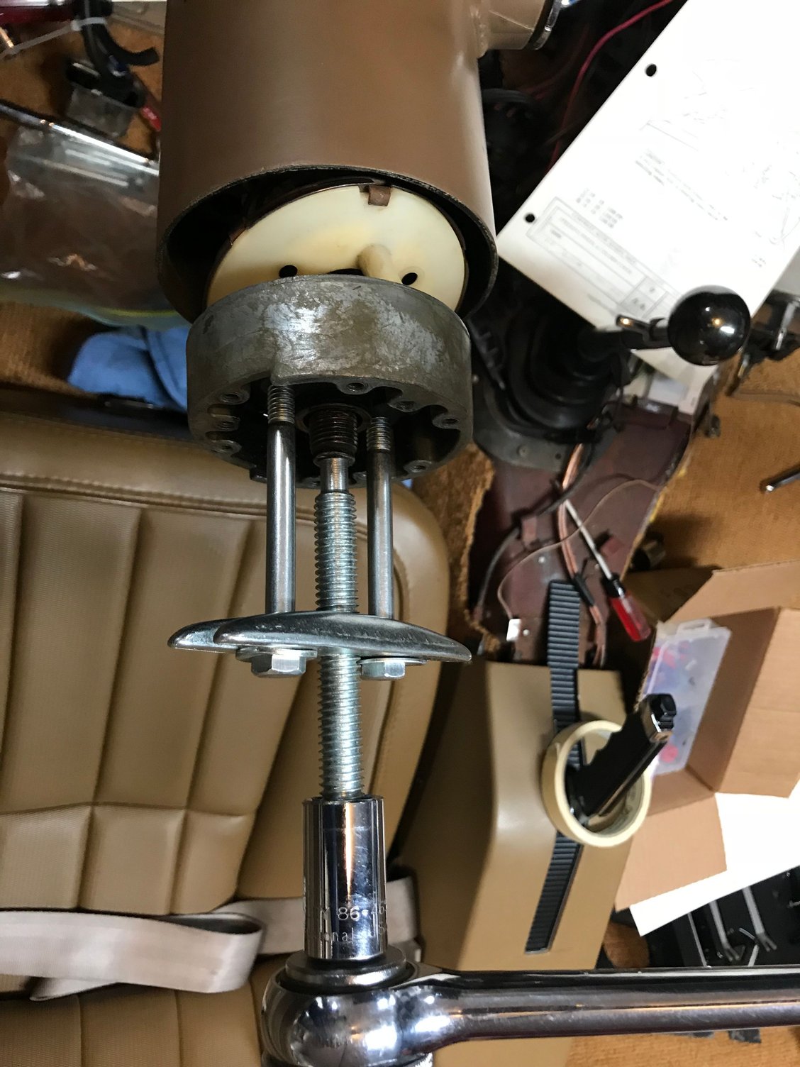

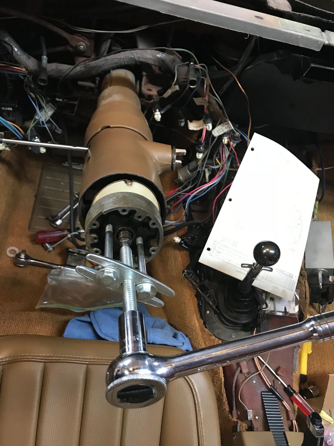

Sorry about that, hit the wrong button on this keypad. Let me repeat that last reply to thread...on my '69 T & T steering wheel I'm having a heck of a time removing the "Nub Arm" (just above the horn contact pin). Have removed the 3 screws on the back, put a puller on the nub arm and can't budge it off. Tried tapping w/a hammer, ran all sorts of penetrating fluid down it...still no luck. Any ideas/advise out there? Thanks in advance.

that's no. 11 on the 69-75 picture ? if it is what your referencing its the Hub Asm or assembly .
all I can offer is to bump this to the top again .
you should really start a new thread with pictures

This puller was not able to pry it loose!
This hub arm does not want to come off!
