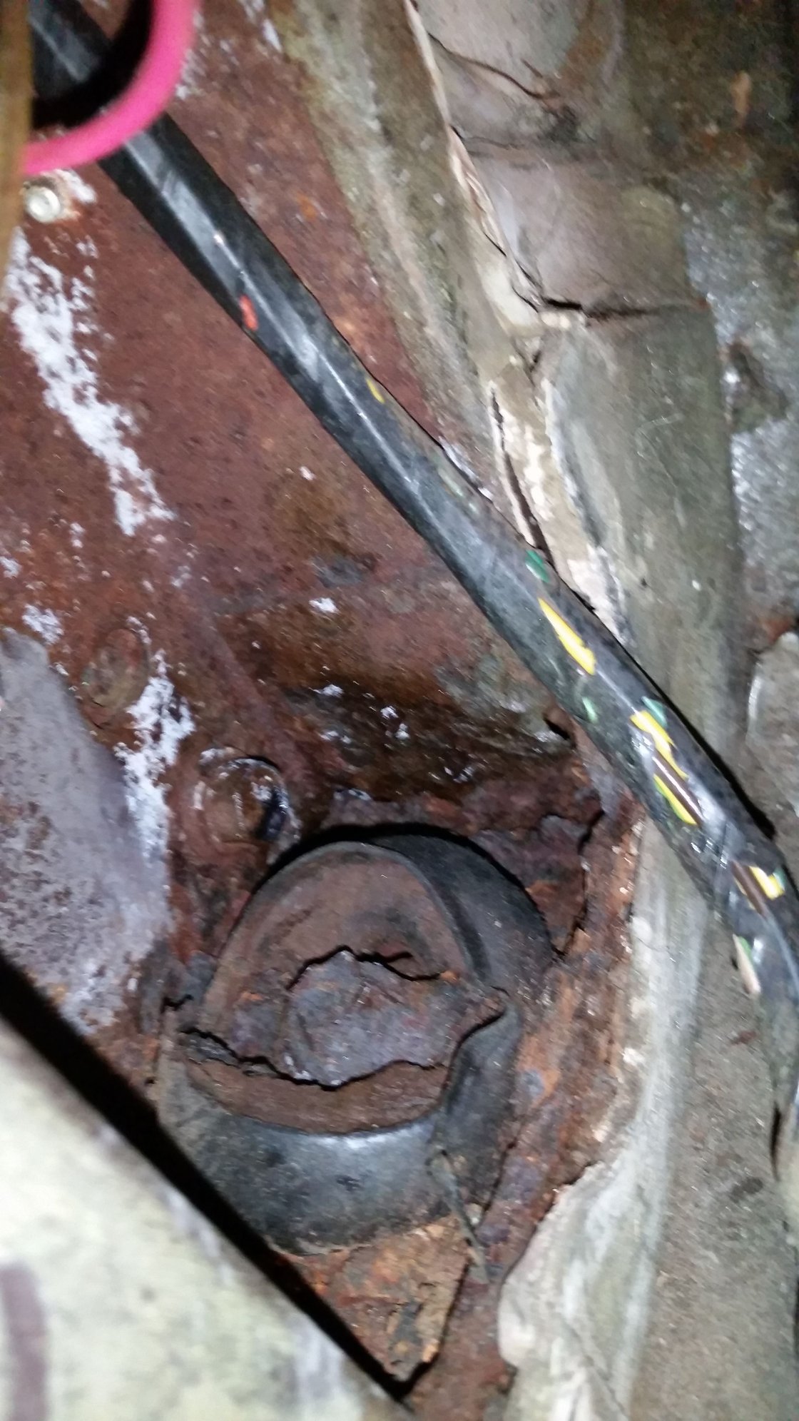

How ****ed am I?

Old Oct 19, 2014 | 07:29 PM
parkerracing's Avatar
parkerracing
Joined: Sep 2003
Posts: 4,206
Likes: 8
From: Belmar NJ
If that's the only spot, it can be repaired, if the whole frame/birdcage looks like that, you're pretty screwed.
Old Oct 19, 2014 | 07:30 PM
F22's Avatar
F22
Joined: Oct 2006
Posts: 6,842
Likes: 285
From: Palmdale CA
Look underneath... Windshield frame is worth a look after that. Not good, but others dealing with it on this form rzfio's thread worth looking at, especially the last three page's. Sell it now, or deal with it. Not cheap or easy, but you love these cars or not,
Old Oct 19, 2014 | 07:59 PM
BDoc's Avatar
BDoc
Joined: Jan 2013
Posts: 326
Likes: 7
Luckily the frame seems ok. The other kick panel is similar, though, and the upper windshield frame is fairly bad on the inside. I don't know about the rest of the birdcage yet...

Old Oct 19, 2014 | 08:04 PM
Paul L's Avatar
Paul L
Joined: Aug 1999
Posts: 30,995
Likes: 98
From: Ontario
What are we looking at?
Old Oct 19, 2014 | 08:18 PM
MrJlr's Avatar
MrJlr
Joined: Feb 2006
Posts: 12,239
Likes: 19
From: Chino CA
Rusted body mount.

Old Oct 19, 2014 | 09:59 PM
drkness01's Avatar
drkness01
Joined: Jun 2014
Posts: 161
From: Pensacola FL
What year are we talking about? <74 keep it and work her back to health. 75> Turn a wrench for a few days, so you know exactly how far the damage has gone.
My mentality is keep a chrome bumper until the world ends, sell a rubber bumper if the resto-mod cost gets bigger than 5k.
Being a FL native and understanding our humidity issues ... I would take a week off work and invest in alot of wire brushes and PB blaster.
Start brushing off all the rust you can find. Seal all the rust you cant remove (walmart primer and enamel works in a pinch). If at anytime during the process you think "Wow, this metal looks thin!". Put it all back together and look at selling it to a corvette parts place.
I know selling a C3 hurts but there are some nicer ones for sale for decent prices in our areas. A lot of the old timers (original owners) retired to Florida with their cars.
Old Oct 19, 2014 | 10:42 PM
20mercury's Avatar
20mercury
Joined: May 2008
Posts: 3,751
Likes: 719
From: Lafayette Louisiana
Default good advice here.
good advice here, I would say for 74 and up C3's, if you have major repairs, consider parting it out unless you have an unbreakable emotional attachment to the Corvette. The problem is it costs the same amount to fix my 76 (mostly) as it does a chrome bumper. And the chrome bumper in the foreseeable future anyway is worth 2 to 3 times my 76. So, it is very easy to get bad upside down on the 74+ with so much money invested you will never even get close to getting it back. My 2 cents. By the way, harbor freight sell a remote tv viewer, sometimes on sale, for pretty reasonable price that you can use to look inside the frame and elsewhere you can not see.

Old Oct 20, 2014 | 07:45 AM
Eljay's Avatar
Eljay
Joined: Jun 2013
Posts: 1,076
Likes: 148
From: Hunterdon Cty NJ
You can also rent an inspection camera from Home Cheepo

Old Oct 20, 2014 | 02:06 PM
drkness01's Avatar
drkness01
Joined: Jun 2014
Posts: 161
From: Pensacola FL
$12 on fleabay you can get a 5m long inspection camera that is USB. I have one on the way.
