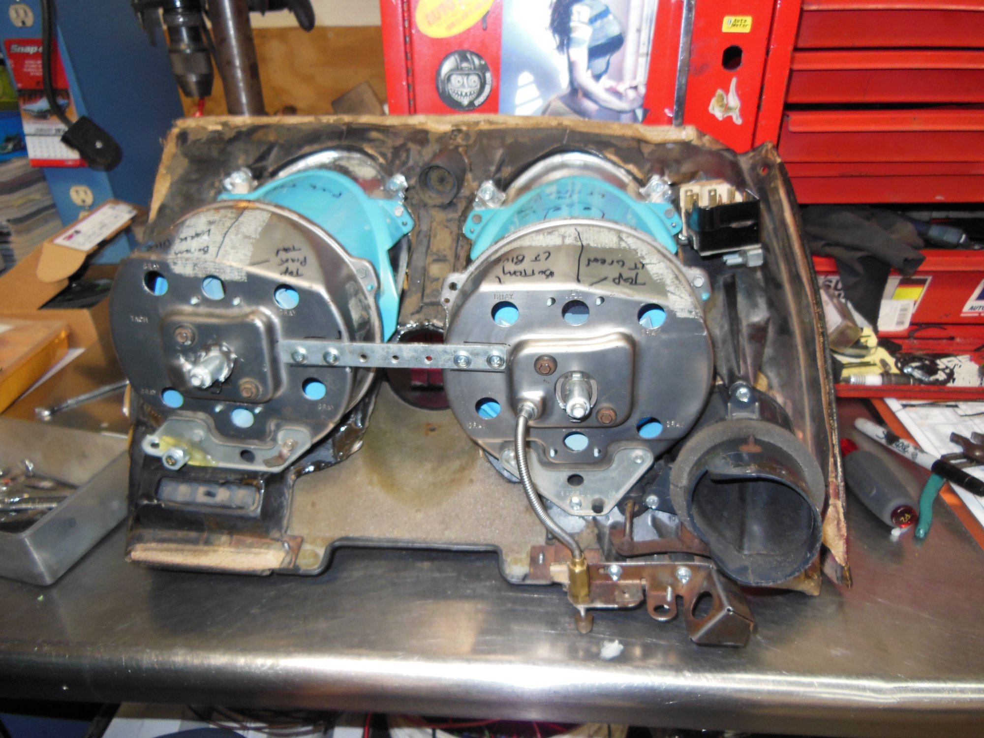

Originally Posted by TWINRAY
Say a prayer cause it's alot worse getting it back than it was getting it out.
That's for sure! One thing that helped was putting a piece of metal between the speedo and the tach across the back and it reinforces it, really well. It adds triangulation to just the front and you can't bend it anymore. The spine between the speedo and the tach is weak and too much handling, makes it handle like a real life, dead Stingray in your lap. It ain't pretty, but it sure works good!
Next try this amazing trick to melt away aggravation in minutes, while installing your dash. Didn't damage the holes either, but you start like this and cinch it up as you plug in lamps. With the lamps, start on the bottom and work your way to the top, so you're not reaching around the lamps and their sockets, because the it doesn't take much to damage them.
Notice how that reinforcing bar, acts as a rear support for a long nylon tie wrap? Centered nicely too.
Great idea with the reinforcing bar. ALSO..notice the tach plate that attaches to the console back face. This place is different than the tach plate for the early C3's. I bought a repro driver's side panel for the 70 and the tach adaptor plate in the 70 didn't fit. I had to buy a new adapter plate for the tach from ebay.
BTW...after you've removed your driver's side dash and years have gone by (talking my 68 here) and the firewall harness has been removed around, it's going to be impossible to get the driver's side dash back because of wire harness/speedo/tach cable interference. For my 68, I had to remove the tach and speedo and then install the driver's side dash.. With the tach and speedo out, I could put my hands into the holes and move the wire harness etc around to make space for the tach and speedo...success. Once I got the wire harnesses in place, I removed the driver's side dash console and replaced the speedo and tach and re-installed the completed assembly.
About those pesky lights around the speedo and tach. I create a separate harness for all the light bulbs and a separate harness for all the connectors from the dash harness...all to be connected by a connector.
Good stuff! I read it twice and still have to really use my imagination to visualize how you did it. I did like the separate wire harness for the dash light. Next time it has to come out, I swear that's what I'm going to do!
