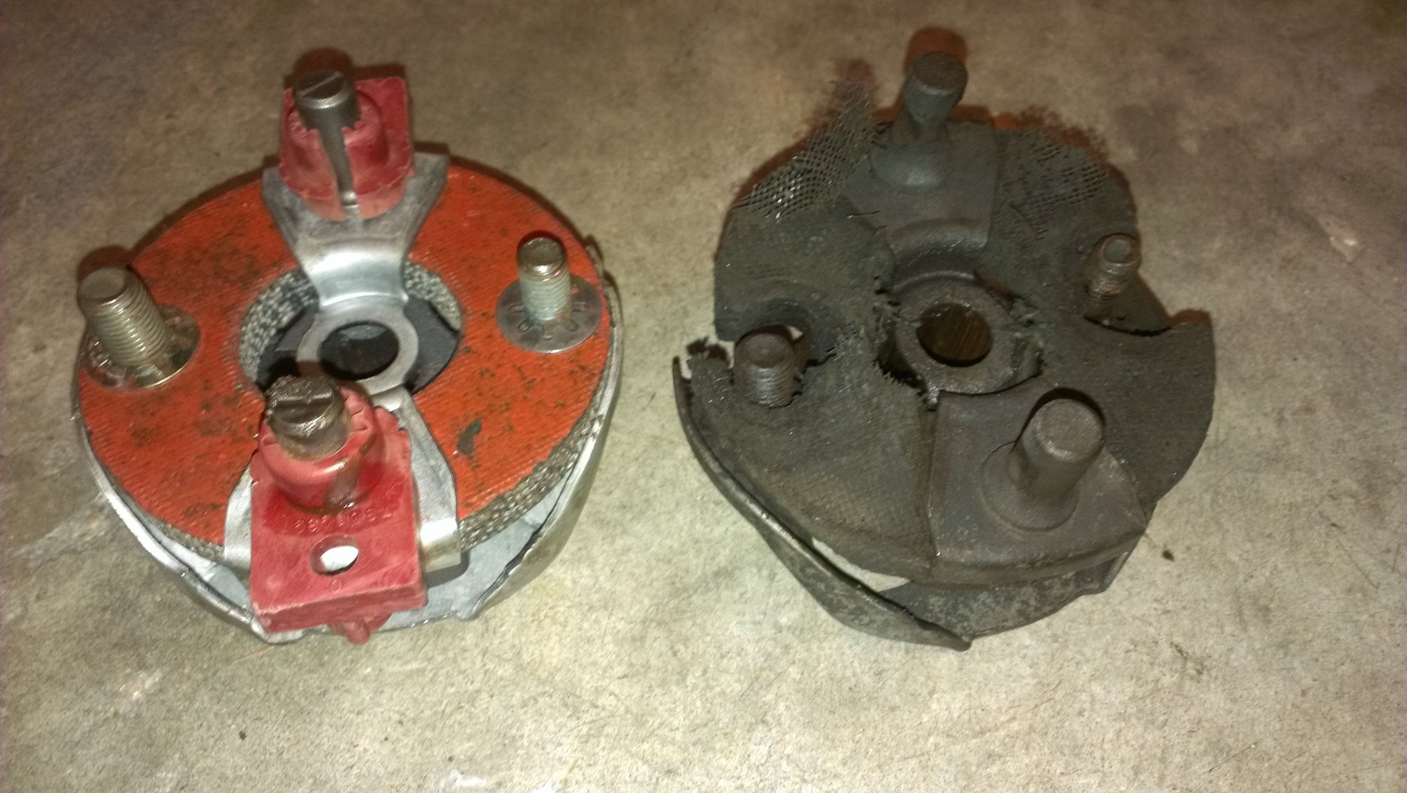

Do a visual. How does the rubber disk look? Frayed or otherwise beat up is not good. How do the safety pins look? Grooved like below is bad. Also, recommend reading Jim Shea's flex coupling articles here...
http://jimshea.corvettefaq.com/?cat=5
Side-by-side of my new rag joint with old...
Safety pins on mine were scary!
