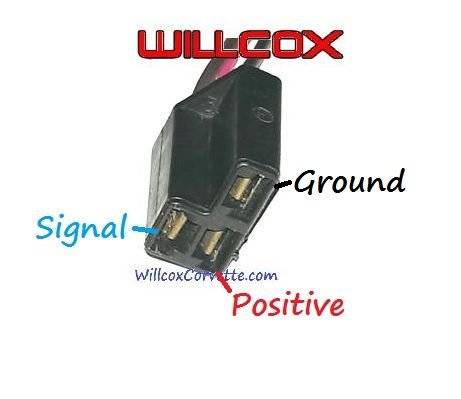

my question is about doing the zero set. Is this done when I put it back in the car or do. I do this on my bench, if I do it on my bench what is an acceptable power source, jiffy jump, battery, etc. thanks for any and all ideas
Do it on the bench and when doing the zero set, use a 12 volt power supply or a battery. Do not use a battery charger. Pull the needle, apply 12 volts and ground and then pop the needle back in place per the instructions on the video.
The car is a 75-77 style so taking the tach back out of the car is a pain. So.. before you install the tach back into the dash and the dash in the car, I would run a jumper wire from the distributor to the coil input on the board, steal 12 volts and ground from somewhere on the car and then make sure everything is working fine by starting the car. Then install it, if you have a installed failure you'll know it's not the tach.
