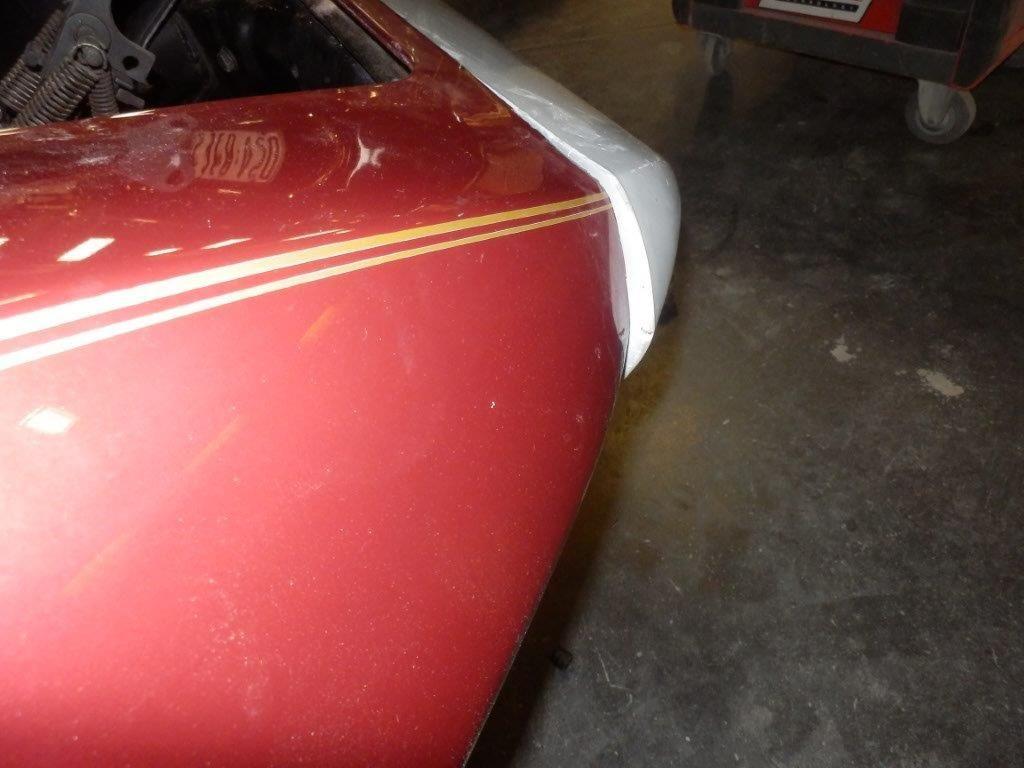

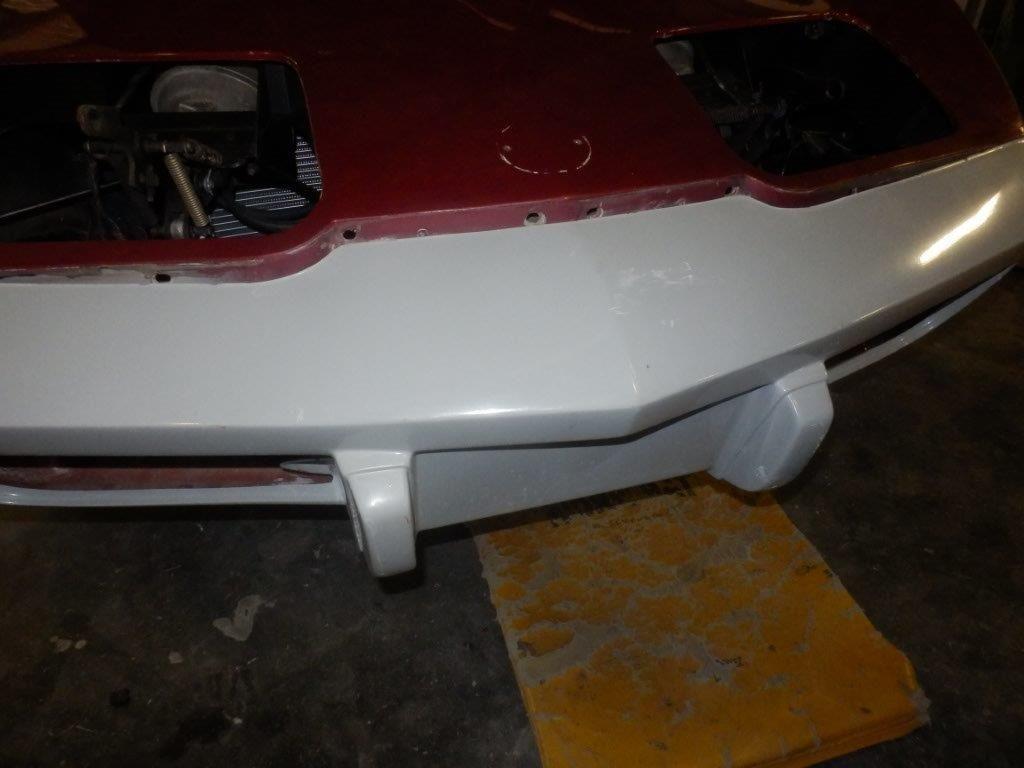

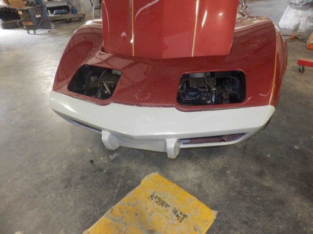

Hi does any one no the difference between a 75 to 79 vette bumper and other c3 ones.
I purchased one for a 75 from Ecklers for a 75 and no way would it fi t, contacted Ecklers and they don't seem to want to discuss it , they seem to think I am having a go at them which is far from the truth . When bolted up has a huge gap in the middle and over hangs on sides, I am thinking somewhere it has had a new front clip maybe a 73 or 74 and that,s why the 75 does not fit .
the shape of the pointy bit in middle seems much different .at least 1 inch gap when bolted on ends.
I did not expect just bolt up but would need major cut and shape to get any where near and if it was a urethane one no way you could do it . Hope someone can tell me diff between these model for future reference

The bumper and nose in your pictures, are both correct for a 75 Corvette. The 73-74 nose comes to a point in the center, between the headlights. The flat inset area on your nose, is not there on 73-74's.
Fiberglass bumpers usually need a little massaging, to get them to fit, but we're talking fractions of an inch, not anything like what your experiencing. The problem may be partly attributable to the bumper, but I think the problems go deeper. I'm guessing that the car has had some nose work done on it, by someone who didn't know what they were doing.
How did the old bumper fit, or didn't it have a bumper? If it didn't, now you know why!

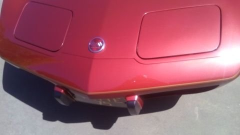

yes I sent Ecklers pic they don't seem interested also sent them to there tech dept and they said it all looks ok that they just need a little work no 2 cars are the same.this is so far out it crazy.
Yes it had a bumper on it which the restorer repaired and it fitted ok just had damage on corner from shipping to Australia in container.
this is now after repair
Happy with repair just want to no why that front did not fit for future reference and because now the repairer is stuck with it as eckers wont take it back
