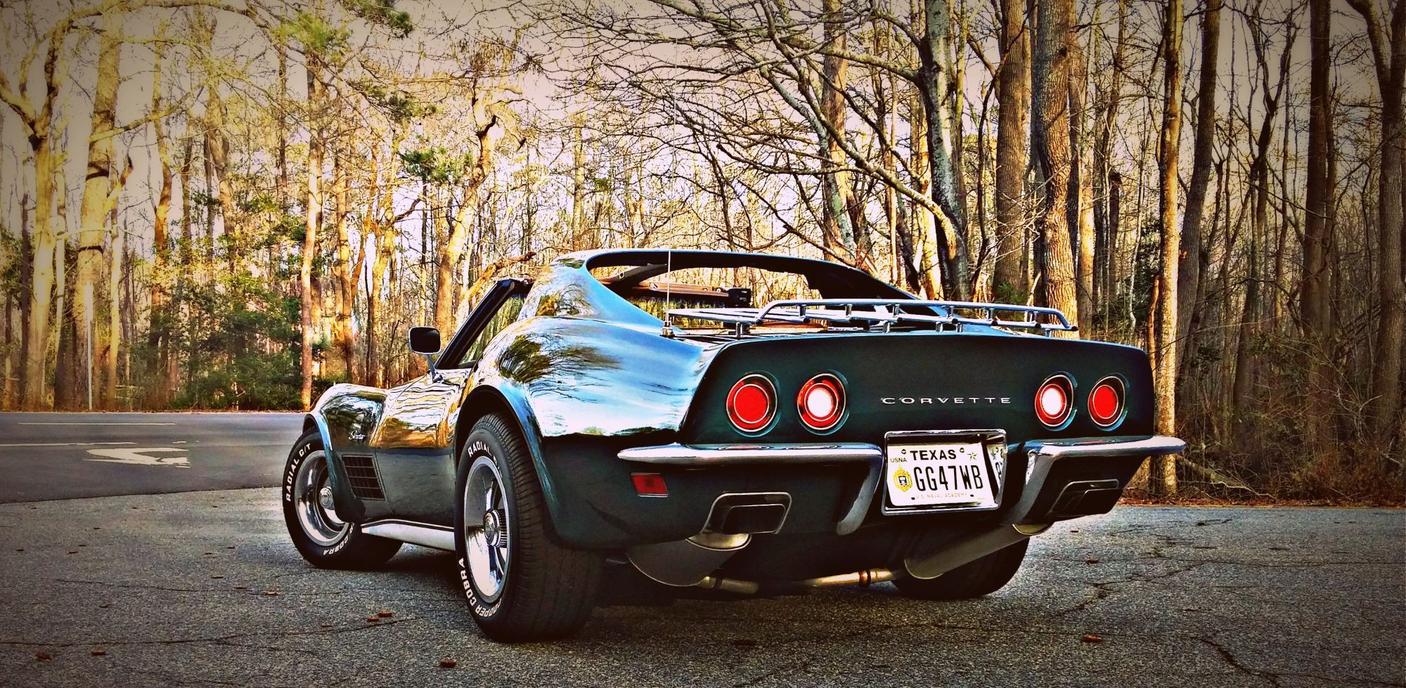

Purchased these from corvette mods and I love them! Definitely retain the originals and make sure you replace the original flasher with a digital one so there are no timing issues with the new LED setup.
