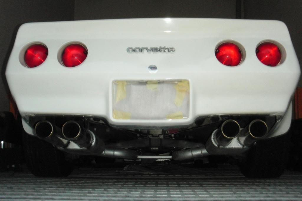

I had Flowmasters and they were very loud, not by definition or opinion, just LOUD. At idle and any rpm. Some drone inside cabin, but still ok for that aspect.
The extremely cammed SB may have also contributed to the sound level, Hooker Super Comp headers and 2,5" duals with H-pipe.
But i don`t think they would have been significantly different on a more civilized motor with a smaller cam, maybe a bit.
A friend in a side road, a few minutes to walk to him, told me his windows vibrated in the frames when i drove off from from my place.
All the neighbors faces showed up in the windows when i started in the garage.
Some people showed me signs to slow down even when i was at normal speed, sometimes, like at a gas station, someone came to interview me why that car is so extremely loud.
With cops around i had to keep it at idle, then it was a little less. But not to easy with the big camshaft to drive it at low rpm, had to use the clutch for it.
Although the sound has a somehow tinny note to it, with that engine the Flowmasters fascinated me, no matter at idle or when i revved it, where it really screamed. Different, but nice. Pure race sound.
After the swap i have also felt they clearly helped for power - on a more normal SB i don`t know how big that effect would be, but that engine/cam was very responsive to the exhaust.
There is not much inside them, so it should be clear they are more racing exhaust noise level.
I don`t have a side view, but on that picture are the pipes that i added to them.
Because of the bullying over the years i modified them a bit to be more quiet and get some of the light tone out of them.
I don`t have a side view of the pipes that i got welded onto the mufflers, but they were around 12" long, so there was space to add some layer of fiber into it.
The wool in the four pipes reduced the noise and took away some of the shrill tone.
Unfortunately that also reduced power, but i think two layers of wool have been one layer to much.
The Flowmasters on that car were really cool at idle and gave me goosebumps when i revved it, but on the current build, if i wouldn`t already have Sideys for it, i would try out Magnaflows.
