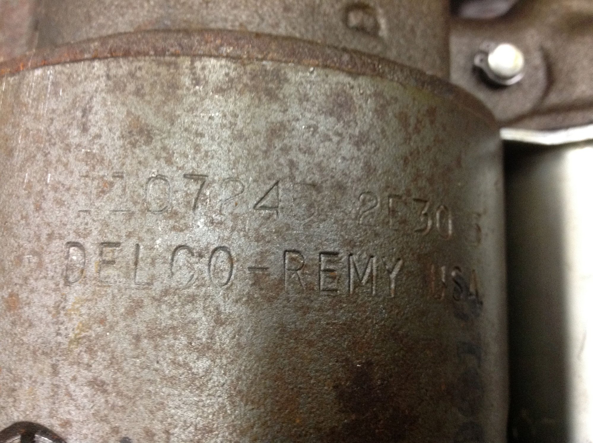

I have this starter motor that came with my 68 vette.
It was new in a box, did the 68 BB use this starter?
Thanks

Don't know the answer to your question but the date code indicates May 30, 1962,1972 date. I know a starter with a part number ending in 242 is for a 62 Corvette with Automatic.
Your starter is not from a 68 big or small block.
I am sure others will have more info.

Thanks Gsimon,
I'm glad I checked I didn't think it was the original as it looks like it's never been used.
